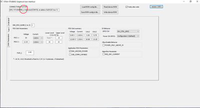

I have bought EVAL- SCS001V1 sink device for my application in which I need the output as 12V/2A from the mentioned sink device. I came across below problems and I seek help on it.
1) Problem related to STSW-STUSB002 GUI version 2.0.
The first problem is with the GUI version 2.0 as specified. When I made hardware connections as mentioned in the quick start document and I tried to connect the Nucleo- F072RB with the GUI 2.0, I got an error which says " The Parameter is Incorrect". and I'm unable to connect the hardware with the GUI 2.0.
I have resolved this issue by using the previous version ( STSW-STUSB002 GUI 1.09 ). So my hardware got detected in this version and I was able to program or write the NVM successfully. In the Connection Status of the GUI 1.09 it showed that " OK STUSB4500_L Detected (COM19), at address 0x28 (I2C bus 1)" sharing image below.

Checking accurately GUI snapshot it seems that you are using STUSB4500L and not STUSB4500.
STUSB4500L is TypeC only, not USBPD. It can explain why you never get power nego with this part...
Best regards
Nathalie
2024-06-04 9:44 PM

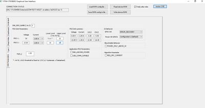

The IC I'm using is STUSB4500 which is confirmed. In GUI version 1.09 it shows L but the IC is STUSB4500 only. Sharing screenshot of GUI version 2.0 for your reference.
2024-06-04 10:06 PM - edited 2024-06-04 11:42 PM
We didn't have USBPD analyser so I'm not able to trace the details. The power negotiation for 9V profile and 12V profile is occuring but when tried for 15V and 20V profile I'm getting output as 5V. I have check this on EVAL-SCS001V1 board as well as multiple custom boards too. Please check this and help on it. Also kindly check the .bin file which is provided.
