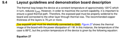

EP stands for Exposed Pad, which is used to improve thermal performance. This is common on many chips and generally it should be connected to GND. This chip is no exception:
There are guidelines given in the datasheet. Basically, it should be well connected to a large ground plane which acts as a heat sink.
