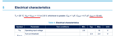

I just bought 10 pcs of LDL1117S33R which i plan to use them to power 3.3V modules form a 4V regulated source.
According to the data sheet the typical dropout is 350mV and max is 600mV @1.2A. My module consumes less than 500mA, so i expect to have enough margin with a Vin of 4V to get 3.3V at the ouput. But the module doesnt boot at 4V input.
When measured the dropuout is 1V -  1.1V. Did anybody face this problem?

@ves011 The max 600mV for the LDL1117 is specified for an input voltage that is at least 1V above the output voltage. With your small voltage difference, I would recommend switching to an ultra-low dropout LDO, e.g. the LD39100PU33R.

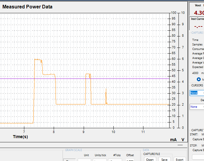

@Andrew Neil wrote:
Often the current required to boot is more - sometimes much more - than the operating current ...
Called "inrush current" :
https://www.matsusada.com/support/terms/ps/rush-current.html
Here is the boot current captured with power monitorScreenshot 2024-11-27 170250.png
its 60mA. Later on when WiFi is enabled and communication starts it has spikes of ~500mA
To make it more clear, with 4V input the output is 2.94V which is more than 100mV below the rated output.

when Vin > 4.4V,  Vout is steady 3.369V. I tested it up to 6V
Vin   Vout
4.3 - 3.236
4.2 - 3.138
4.1 - 3.040
4.0 - 2.942
all these on a constant load of ~20mA
What @Peter BENSCH said confirmed your findings.
4.3 - 3.236 = 1,064V
4.3 - 3.236 = 1,062V
4.1 - 3.040 = 1,06V
4.0 - 2.942 = 1,058V
