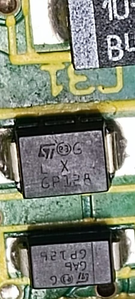

Could someone tell me what type of diode I have? I can't find any data.
L X GP128L X GP128
I appreciate your help.
"LX" marking = SM6T15CA
600 W TVS diode in SMB package
https://www.st.com/resource/en/datasheet/sm6t39a.pdf

It makes a lot of sense, I appreciate your support.
