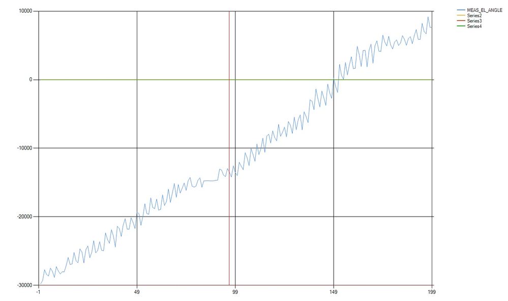

Hello!
I have same problems with encoder. counter in TIM4 counts encoder steps with error in some cases.
I made experiments without V+ connected, power was only through USB port.
  1. If motor in STOP state It counts steps correct.
  2. If motor in RUN state (press "Start" button) It counts steps with errors:
    1. I rotate motor shaft for one revolution. It counts less steps than in STOP state
    2. I rotate shaft clockwise and counterclockwise for a small angle near "Zero" position, but "Electic Angle" variable accumulates its

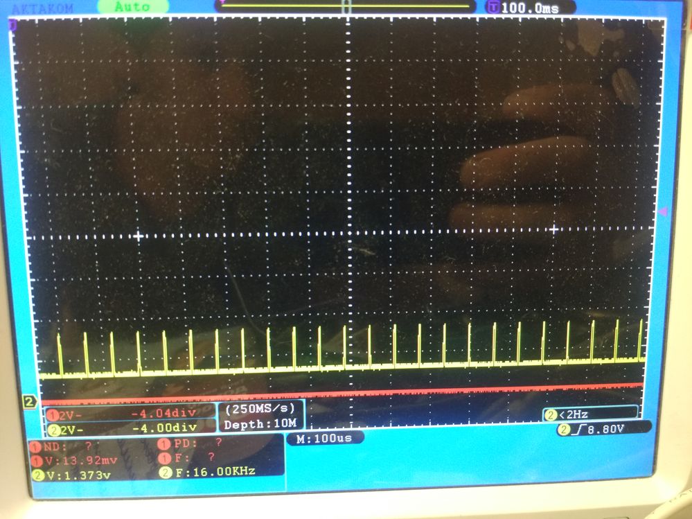

I wondered this "magic" and used oscilloscope..
In RUN state:
Red line is V=0, Yellow line is signal on "Encoder A" pad on the board. with no encoder connected
In STOP state signal on this pad is correct.
My both kits has the same problem.
What should I do to fix this problem?
