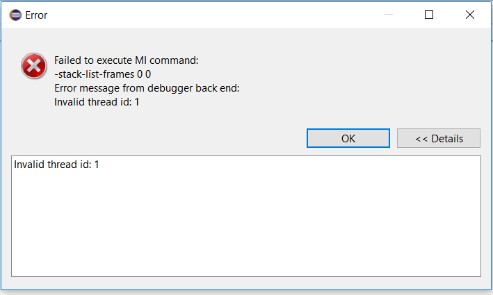

i am using SW4STM32 (Version: Neon.3 Release (4.6.3)) with the STM32F4 discovery board. Since i updated to this version, i get this error message when closing the debug session:
''Failed to execute MI command: -stack-list-frames 0 0
Error message from debugger back end: Invalid thread id: 1''
I cannot reasolve it, can you please help me to understand / resolve it?
Thank you!

Having the same issue here.

I still couldnt solve it, any suggestions?

Same issue here. Also, the debugger freezes when single-stepping in the SysTick handler routine. This started with an update of Eclipse Neon and is also present in Eclipse Oxygen.

I did and update of SW4STM32 and now it works again. I have STM32 CUBE firmware version V1.16.0 and Eclipse Neon Release 4.6.3 now.
