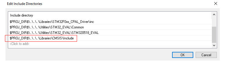

Use the latest version of IAR to compile the standard peripheral library, get some faults.
Xwang.41
IAR version is 9.10.1, the lib version is 1.5.0 for F0 device. The IAR expose a lot of faults about "core_cm0.h". I do not change anything, just open the project file under "EWARM", then compile.
Imen.D
Hi @Xwang.4​ ,
In fact, this issue also appears when I used old release EWARM 8.50.6 and it’s caused by wrong path to core_cm0.h file.
Could you please try the following steps and let me know if that fixes your issue ?
  • Open the project template using EWARM v9.10.1
  • From project options -> C/C++ compiler add the following path:
\Project repository\STM32F0xx_StdPeriph_Lib_V1.5.0\Libraries\CMSIS\Include
  • Build the project
Note: the project in "STM32F0xx_StdPeriph_Lib_V1.5.0" package was developed using an old IDE version (EWARM V7.30.3)

However, the CMSIS headers like core_cm0.h contain specific defines for several different toolchains.
You might need to set the IAR-specific define (__ICCARM__) on project level.

Thanks, it can be compiled correctly.
