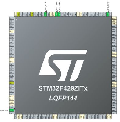

I’ve encountered a new issue while debugging using GPIO->IDR to directly read the encoder signals.
I’m using two separate RS422-to-TTL converter boards, and I connect their outputs to PA0 and PA1 respectively. However, I noticed that only the signal connected to PA0 responds correctly and follows the encoder changes.
The one connected to PA1 behaves abnormally — it either doesn’t respond correctly or gives unstable results.
Interestingly, when I connect the same signal (from the problematic converter) to PA0 instead of PA1, it works fine.
So it seems like the problem might be related specifically to PA1 not reacting properly.
Do you have any idea what could be causing this?
Thanks again!
Attached is a short video of my test setup and the issue I described earlier.

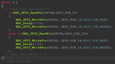

To verify whether the input signals are working correctly, I used the onboard GPIO LEDs to manually check the waveform behavior from each RS422-to-TTL output.
I've attached a video showing the test.
Based on the experiment, all signals behave as expected until I connect them to the TIM2 encoder input pin PA1. That’s when the abnormal behavior begins.
This suggests the issue may not be with the signal itself, but rather something related specifically to using PA1 as a TIM2 encoder input.
Let me know if you have any thoughts or further suggestions.
Thanks again!

So far, I've narrowed down the issue to the PA1 pin used for the TIM2 encoder input.
When I connect the encoder signal to PA0, everything behaves normally. But when I use PA1, the signal becomes unstable or doesn’t register properly.
I've verified that the input waveform is clean using an LED test, and the signal source is the same in both cases. This leads me to believe the problem is specifically related to PA1.
At this point, I’m honestly quite lost and exhausted after spending several days troubleshooting. I’m not sure what else could be wrong with this particular pin.
Could there be any other possible reasons that might cause this behavior with PA1 when used in encoder mode?
Any suggestions or guidance would be greatly appreciated.
