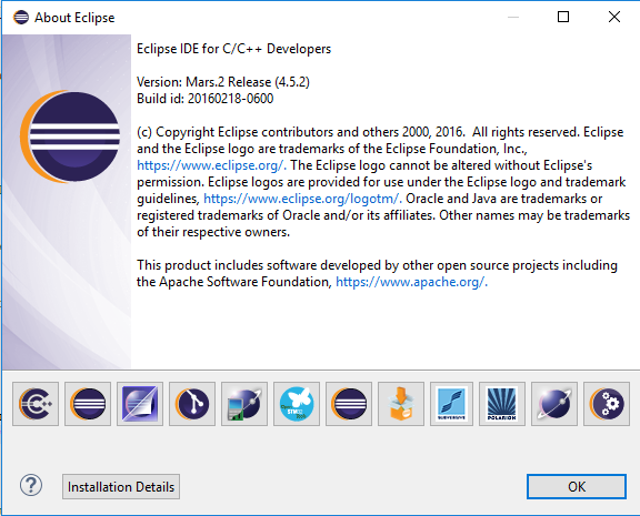

Posted on February 09, 2017 at 17:18
Thanks Olivier,
It seems that I don't have the same kind of help contents.
For me it runs like this:
Help >> Help Contents >>Workbench User Guide >> no Advanced ??
This could be the clue of my problem since in the help nothing refer to stm32 !
Eclipse version:
Posted on February 09, 2017 at 17:22
The version which is required here is the one for STM32 plugin ( blue butterfly )
This specific help have come along 1.12.1 version.
If you upgrade on latest 1.13.1 for sure you will get it
Olivier
