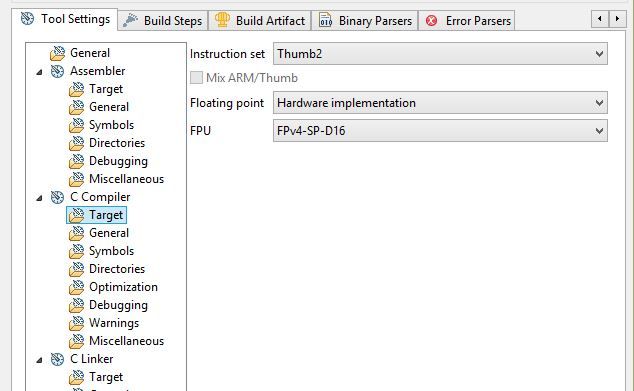

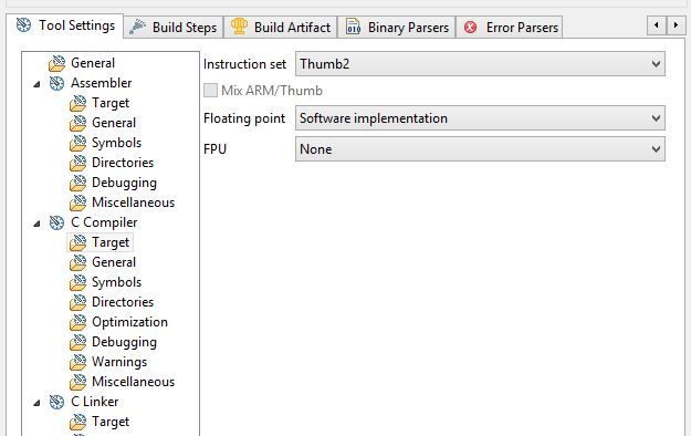

When I compile and link with or without the FPU I always have the same processing time and current consumption.
Here below are the two Truestudio configurations:
With FPU set in Assembler, Compiler and Linker target:
Without FPU set in Assembler, Compiler and Linker target:
What am I wrong?
Why does these options have no effect?
How can I force the FPU usage?
Best regards
Mich
