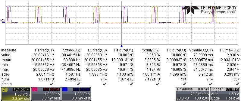

Can i make a 2 PWM signals phased like this?
Phased like yellow and blue waves

Yes, you can do it easily on STM32. You should apply the center-aligned PWM mode (up/down counting) with a different signal polarity. You may want to enable the preload registers to get a synchronized change in duty cycle.
