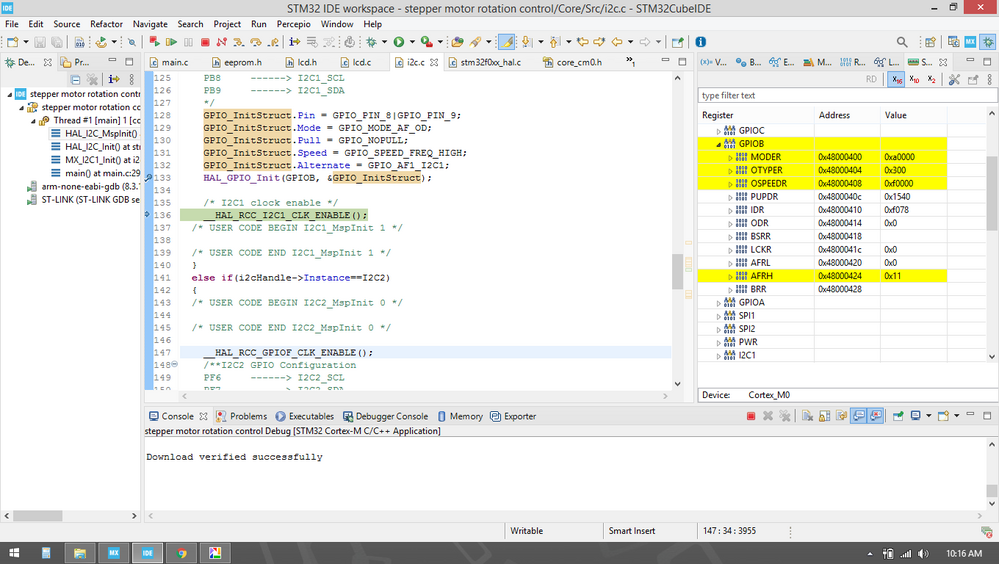

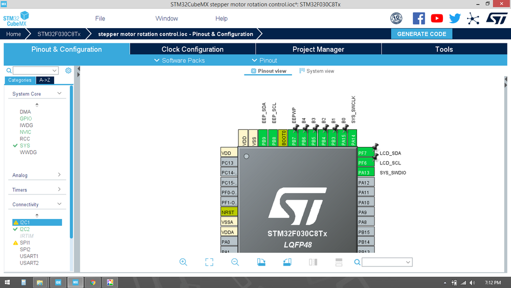

i want to store data in to I2C EEPROM AT24C02 so in MCU I2C1 is used but i saw in oscilloscope I2C1 both pins are remains low
I2C2 works fine with i2c LCD.
i placed pull up resistor 10k both line CLK & SDA in EEPROM.
EEPROM address 0xA0
how to solve it?

3 REPLIES 3
Guru
You don't show your usage of these functions anywhere. Include the entire code if possible.
Your I2C2 initialization is missing a setting to GPIO_InitStruct.Alternate.
The very first thing you should do to debug I2C is to see if HAL_I2C_IsDeviceReady returns HAL_OK. If not, there is a connectivity issue.
If SDA/SCL are both low despite the presence of external pullups, it suggests the pins are not initialized correctly, or there is an issue with your measurement, or there is some other hardware issue.

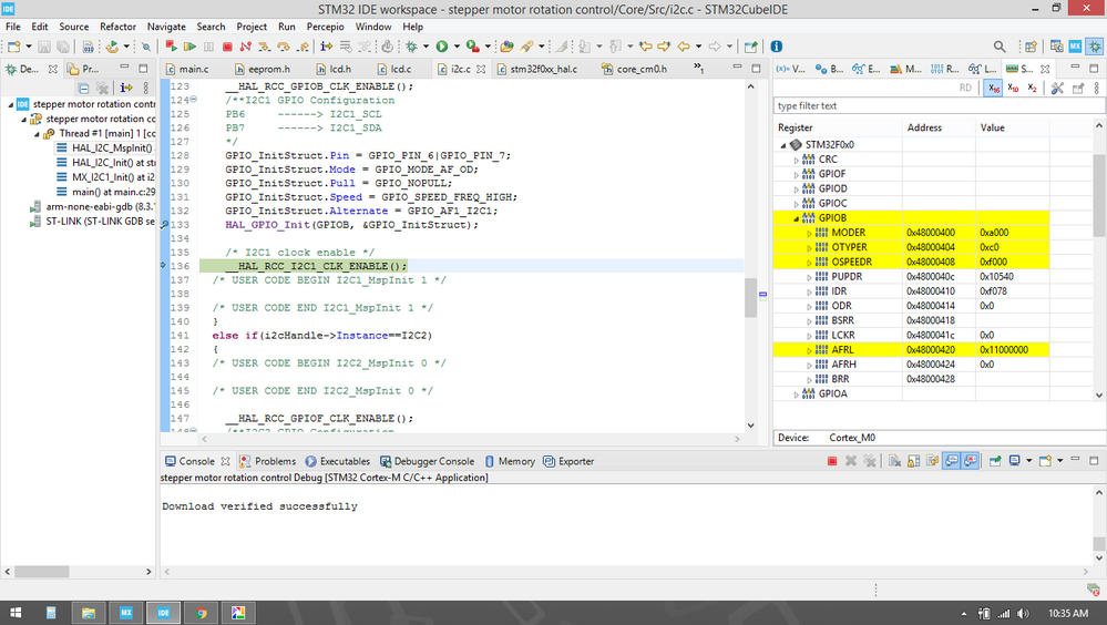

My problem with I2C1 EEPROM not working in I2C1 I'm using alternate pins and in cods line number 132 alternate function it's configured.
1) PB8 PB9 configure as I2C1 then I get EEPROM CONNECTED
as you said i tried I2C1 HAL_I2C_IsDeviceReady is returns HAL_ERROR is there hardware EEPROM problem or any other issue?
2) PB6 PB7 configured as I2C1 then its work fine i get clock in oscilloscope FOR TRIAL
so what is the problem in gpio init code how to solve it?
