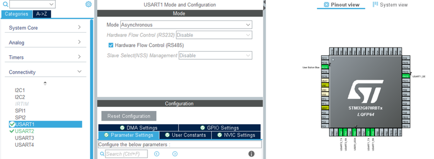

My understanding of USART1 Hardware Flow Control (RS485) is DE (PA12) is SET during transmission and RESET once transmission is completed by MCU. RE tied DE shall give half-duplex channel using MAX485 based TTL to RS485 board connected to USART1 pins, DE & RE to PA12, 5V and GND. Data transmitted is received by slave. Shall see DE and RE values mapped to transmission signals and keep you posted. Thank you.

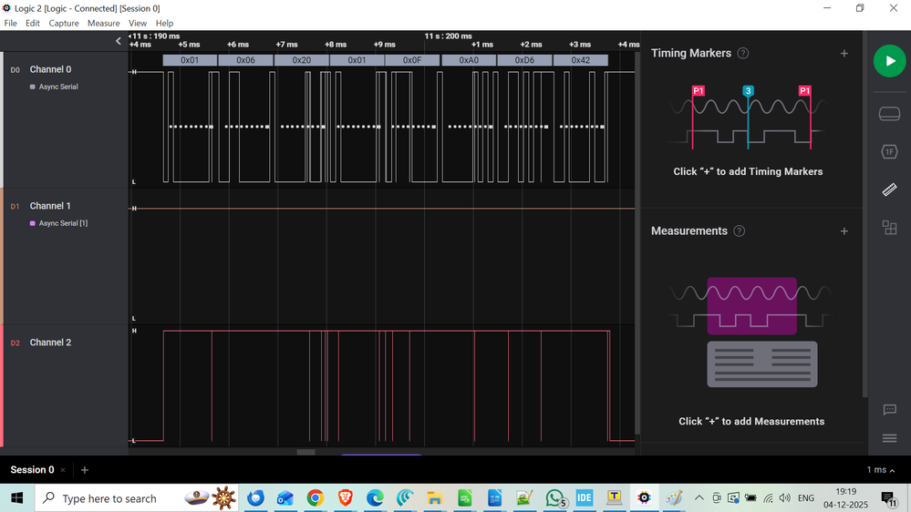

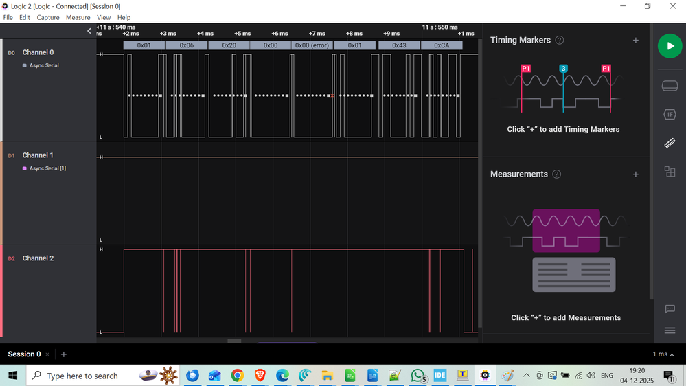

These are captured with Logic Analyzer:
Channel 0: Tx from MCU (bytes are good)
Channel 1: Rx from VFD (No signal at all and hence there is no image for this)
Channel 2: DE (PA12) from MCU (SET during MCU UART transmitting and then RESET)
Somehow VFD does not work now - perhaps I lost / rearranged some lines of code or delay. Need to look at backup code, merge and test.
These are only to show DE (PA12) toggled by hardware (SET during transmit) so that half-duplex mode shall be effective with MAX485. Shall keep you posted after getting code to previous state / condition  (i.e., VFD working).

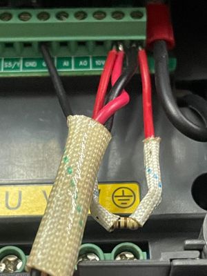

There is 120 Ohm resistor on MAX485 - TTL to RS485 board and I connected 100 Ohm resistor at VFD end.

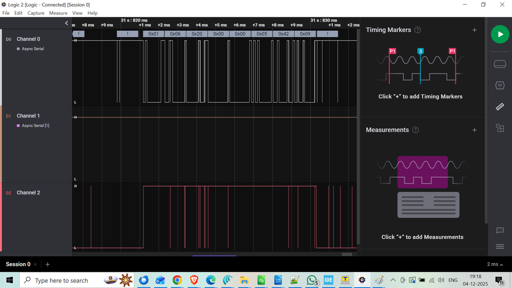

It works fine now. D0 is data sent by STM32 (Modbus RTU Master) and D1 is reply data from VFD and D2 is DE. Rewired and cleaned by merging with previous working code. Issue was probably with
1. Wiring of Rx signal from STM32 to MAX485 (TTL to RS485 board) and / or to VFD.
2. Delay
Updated code to send and Modbus RTU frame is:
tx_status = HAL_UART_Transmit(huart, request, 8, 100);
while (__HAL_UART_GET_FLAG(huart, UART_FLAG_TC) == RESET);
rx_status = HAL_UART_Receive(huart, response, 8, 200);
