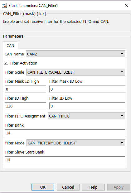

This is the code generated for one of the CAN_Filters, and below you can see the corresponding settings of the block. As you can see, the parameters are written into the code directly instead of as a function call argument, which is why the code cannot be reused in the C-code.
/* Start for S-Function (CAN_Filter): 'CAN_Filter1' (':925') */
/* HAL CAN2 filter configuration structure definition. */
CAN_FilterTypeDef sFilterConfig = { 0 };
sFilterConfig.FilterIdHigh = 0x80;
sFilterConfig.FilterIdLow = 0x0;
sFilterConfig.FilterMaskIdHigh = 0x0;
sFilterConfig.FilterMaskIdLow = 0x0;
sFilterConfig.FilterFIFOAssignment = CAN_FILTER_FIFO0;
sFilterConfig.FilterBank = 14;
sFilterConfig.FilterMode = CAN_FILTERMODE_IDLIST;
sFilterConfig.FilterScale = CAN_FILTERSCALE_32BIT;
sFilterConfig.FilterActivation = ENABLE;
sFilterConfig.SlaveStartFilterBank = 14;
/* Configure CAN2 filter on dedicated FIFO0. */
if (HAL_CAN_ConfigFilter(&hcan2, &sFilterConfig)!= HAL_OK) {
Error_Handler();
