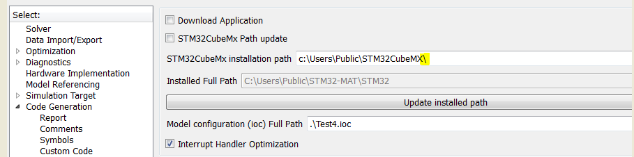

I am having a problem getting the STM32 Embebbed Matlab/Simulink Target to run. I am following the example in the STM32_MAT-TARGET_HandsOn.pdf document for the third example (everything on STM32) step by step, but whenever I try to build the model from Simulink I get the error:

    Error: Syntax error while setting code generation options string: quote mismatch
and no code is generated. I have played around with most of the STM-specific options, but it makes no difference. I am using Matlab R2015b, Win7, Nucleo-F767ZI board and Matlab Target v4.4.1.

Could you please try to remove the '\'at the end of the
STM32CubeMx
path, then tel us about the result :
-Nesrine-
STM32CubeMx
-Nesrine-

Yes, that works better - now the code generation works. I would never have thought that's the problem, although I tried to change the installation paths, making them shorter and avoiding spaces. But I thought that path was only used to launch CubeMX from Matlab to generate a configuration file.
Thanks a lot, that was really helpful!
