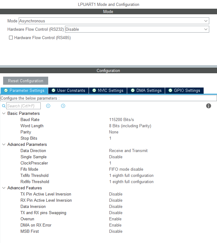

I am trying to monitor a simple model build in MATLAB Simulink and running on my Nucleo STM32G4321RB board.

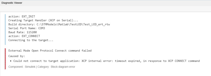

Building and deploying the model on the controller is possible, the code is running properly. But when I try to use the external mode function in Simulink, to monitor the running code, there is an error:
"XCP internal error: timeout expired, in response to XCP CONNECT command".
The model itself is very simple. Read digital input from User-Button and output state to User-LED.
According to the user manual UM2505 from ST, on the G431RB-board the LPUART1 is connected to STLINK-V3E Virtual COM Port by default.
So I have setup the LPUART1 in CubeMX in asynchronous mode at 115200 Bits/s.
And also configured the Simulink model for LPUART1 and COM3 (as given by Windows device manager)
But it just won't work. And I could not find any helpful answers on google for this problem.
I also tried UART1 and UART3 in desperation, but that's not working either, of course.
Does anyone have an idea, how to get this running?
Thanks for your help.
