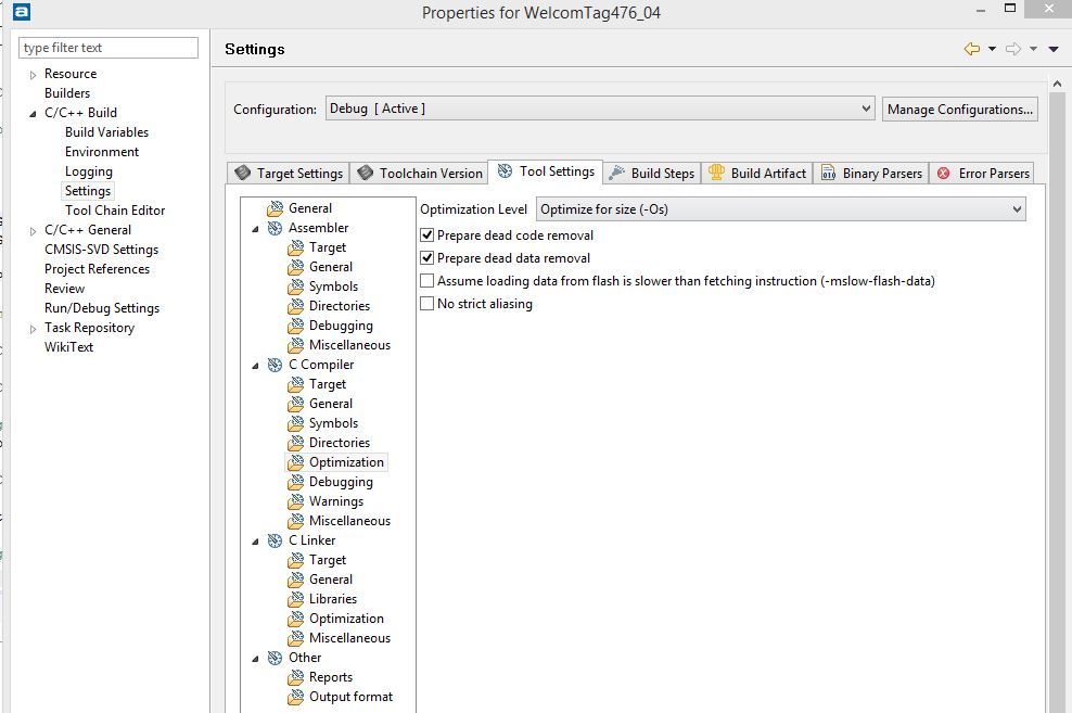

How could I specify the stack size in the graphical interface of Atollic TrueStudio for STM32?

There's no graphical interface except Build Analyzer and Static Stack Analyzer, but they just show data. You will need to use the linker script (.ld file) to specify sizes.

No graphical?
I meant that:
