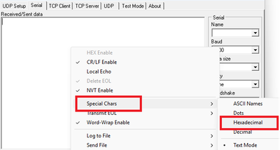

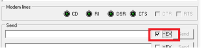

Try Hercule. I didn't test that feature but you can have a try:
To send with HEX format:

It works with Hercules, but I can't get RealTerm to work. Thanks to both of you for your helpful support.
