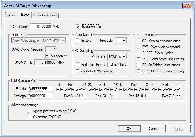

‎2019-02-04 11:39 AM
We might have to revisit this on the ST-LINK V3SET and Keil, the V3 is using a 15 MHz SWV clock, not 2 MHz, so the math changes. This was on a 120 MHz L4+ board, so the frequency/multiples might be different in other environments or use cases.
