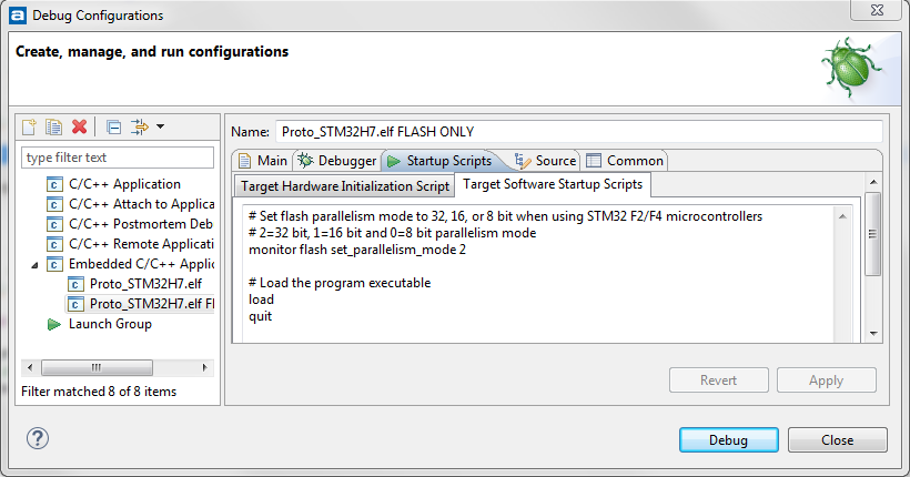

Geo En
Posted on March 07, 2018 at 13:16
For this situation, I have made a copy of the ''.elf'' file in ''Debug configuration'' : ''blablabla.elf FLASH ONLY''.
In this configuration, I have modified the ''Startup script''. I have removed everything under ''load'' and I have added ''quit''.
Debbuger will now flash the device and get back to normal editing mode.
Hope this helps.

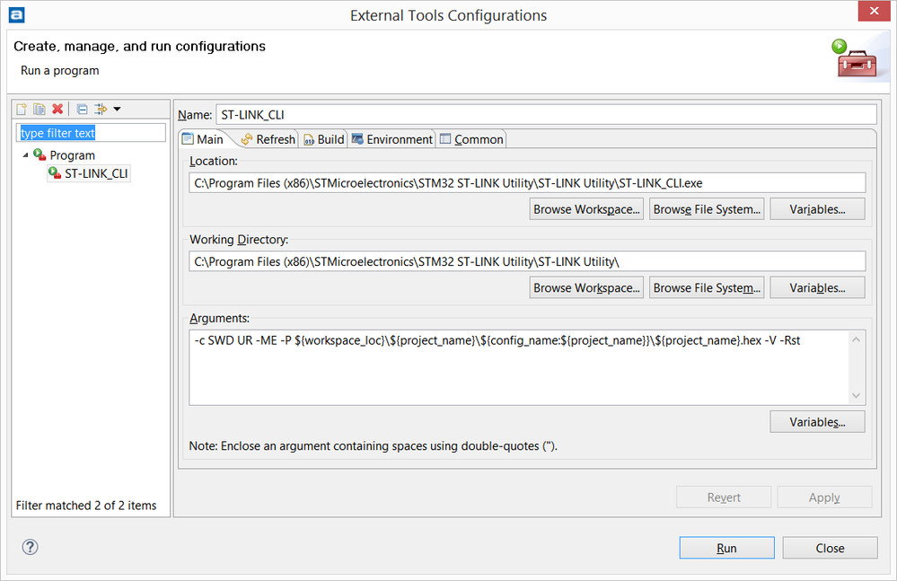

Kraal
Lead
Posted on March 07, 2018 at 13:46
Hi ! The solution proposed by
enjolras.g
is good but the loading process is slower through the debug interface. If you are using the ST-Link pod, I suggest to read the TrueStudio user manual (which can be found inC:\Program Files (x86)\Atollic\TrueSTUDIO for STM32 9.0.0\Manuals\General) on page 194, which explains how to call ST-Link Utility through TrueStudio. It is the method I'm using and it is really fast. However I have not found yet how to create a shortcut to call this easily.
Kraal
Lead
Posted on March 07, 2018 at 14:21
I should add the arguments needed:
-c SWD UR -ME -P ${workspace_loc}\${project_name}\${config_name:${project_name}}\${project_name}.hex -V -Rst
SWD : connect using SWD protocol
UR : connect Under Reset
-ME : perform a mass erase before programming
-P : program the hex file, ${...} is to be able to run the tool for any project
-V : verify the program
-Rst : reset the uC to let it run

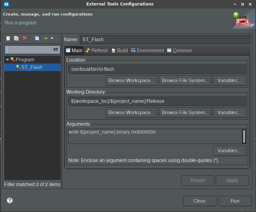

Posted on March 07, 2018 at 15:00
In Eclipse, I configure the External Tools under Run menu like this:
Probably, your extension will be .binary ?
And the path will also differ, as your binary will be in Debug or Release...

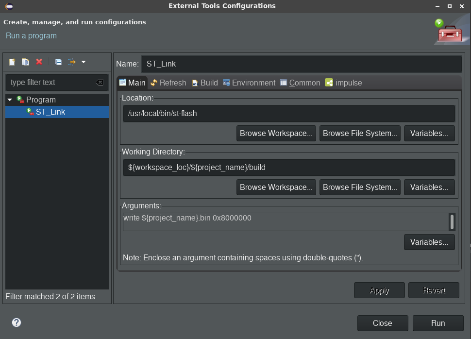

Posted on March 07, 2018 at 15:22
No problem
Kjeldsen.Carl_Nicola
, I do not compete... this is a Linux solution and yes, for the entire workspace but for projects generated for Makefile (IDE independent) and using the @texane tool.
Hmm, didn't realize that I had it setup for Atollic as well, I always reach Eclipse first...
Vanek.Krystof
, for the binary created in Debug folder, you can create another entry in the menu, eventually named ST_Link_Debug... but of course, for the ST Link utility you are using under Windows...

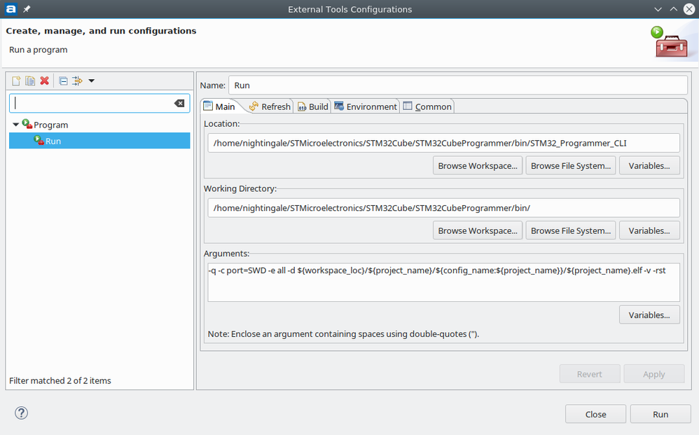

Krystof Vanek
Posted on March 08, 2018 at 11:58
Hi again,
thanks a lot to
Guta_Ciucur.Vasile
‌ and
‌, your solution does exactly what I'd like to.
I just modified it a bit to use with STM32CubeProgrammer (CLI).
The argumets are:
''-q'' quiet mode (no progress bar)
''-c port=SWD'' Choode SWD
''-e all'' erase all memory
''-d .....'' Download specified file
''-v'' verify
''-rst'' reset target
After that i used ''Customize perspective'' to add the option to toolbar.

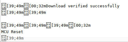

Only problem is the console output is kinda messy, containing some strange characters. This probably is inherited by the system (Linux x64).
