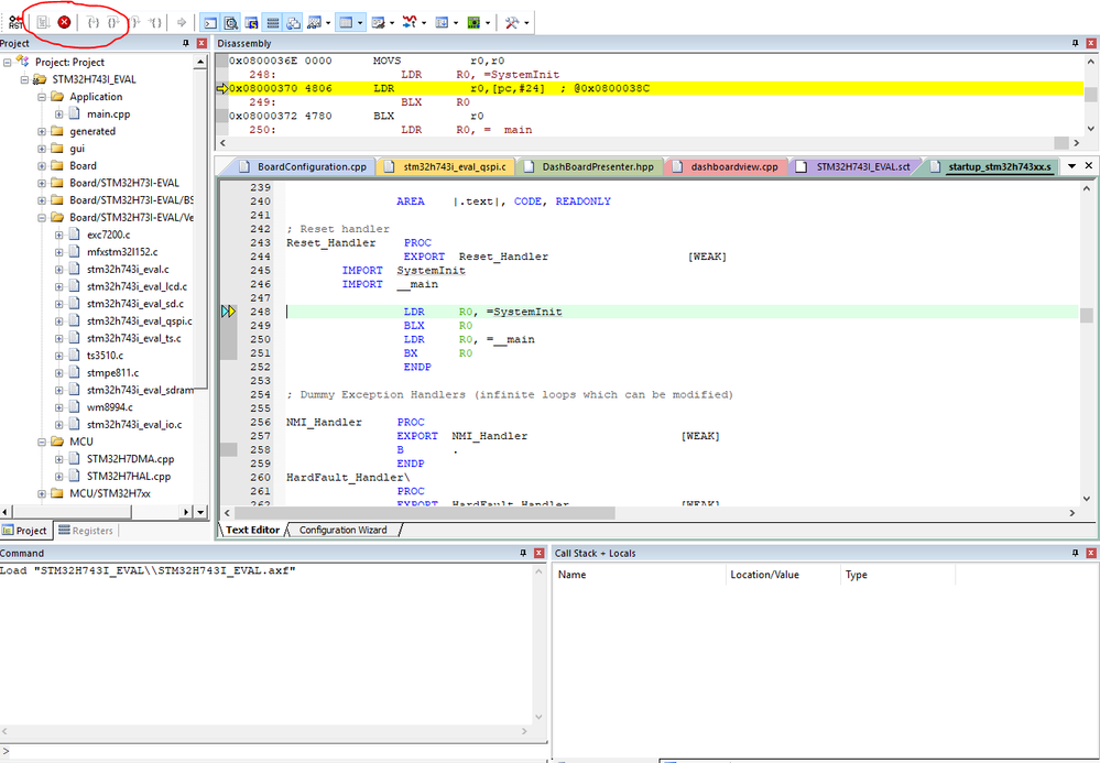

Hi professor,
I`m trying to use debug mode with keil.I get it in to the function and it run the function without press run button,but when I stop it ,it go in to hardfault.
Is any one have faced the problem before?

SystemInit faults? Perhaps step in to that and review the code. Inspect Hard Fault location reported by processor, it has registers for that.
Are you using RAM which needs a clock enabled?

I have enabled the appropriate clock ,and I cannot check the register cause it can`t run normally,just stuck in Reset_Handler.

Use Stop to see where it is.
Turn off the "Run to main()" setting of the debugger, and start stepping into/through the SystemInit() function. Determine where things go wrong, and where exactly it ends up.

I found out where the wrong is,and solved it.
