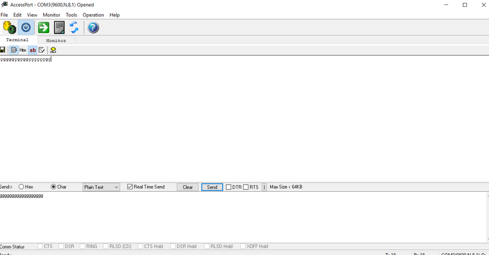

I have tried your recommendations but alas still have the issue. I don't think its noise as its either one of two characters not just random ones. Furthermore, I set the baud rate so there is no remainder when it is divided to fit into the BRR register also to no avail.
The offset between the two characters that I receive seems to 128 decimal which is undefined in the ASCII table. I am at a bit of a loss now
‎2019-05-12 11:01 AM
I have taken a look at the ISR register and the noise flag is being set with every transmission. I have been clearing the flag when it is set. However it is set every time regardless of whether the correct character has been sent or not
void USART2_IRQHandler(void)
if((USART2->ISR & USART_ISR_RXNE) == USART_ISR_RXNE)
USART2->TDR = USART2->RDR & 0xFF;
if ((USART2->ISR & USART_ISR_NE) == USART_ISR_NE)
USART2->ICR = USART_ICR_NCF;
