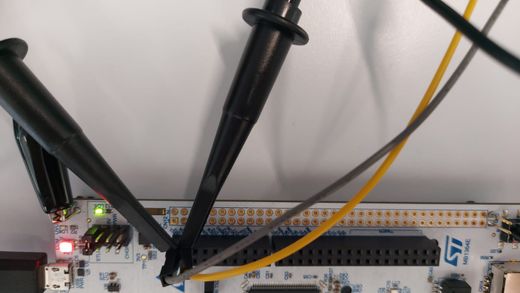

I've this circuit connected to the microcontroller:
Using an oscilloscope and a multimeter I'm always measuring 0V and I can't see the SCL and SDA signals.
Do you know where am I doing wrong?

Because @Andrew Neil  when I measure with the oscilloscope both signals are at 0V. So it seems I have no output signal from the microcontroller.
You still haven't said where, exactly, you did this measurement!
@DannyB wrote:
There needs to be a GND connection between the Nucleo and the mirror PCB.
I'm measuring on the PB8 and PB9 pins as shown below:

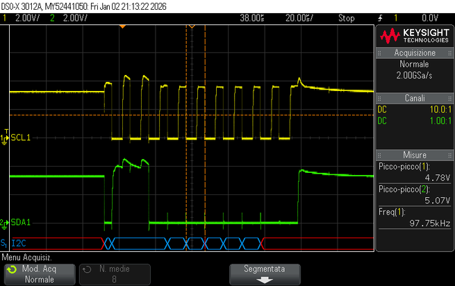

Now I can see the SCL signal but on the SDA signal I see only the slave address, the data is always 0.
I'm trying to send the MEMS_Input2.

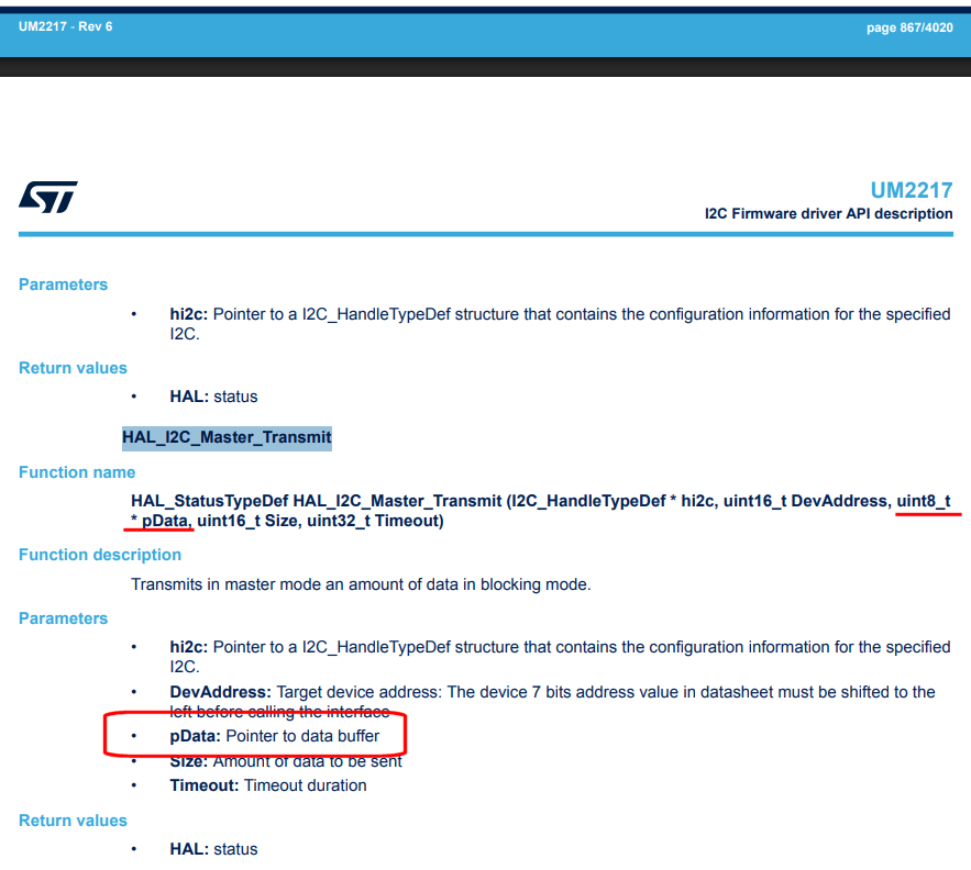

When I send the function HAL_I2C_Master_Transmit(&hi2c1, DAC_Address, MEMS_Digital_Input2, 1, HAL_MAX_DELAY);
I've a warning telling this:
Is that the problem for the data always at 0?
Previously you said you were seeing nothing - So what changed?
Please show a trace of what you see - using your scope's screen capture facility rather than a photo.
HAL_I2C_Master_Transmit( &hi2c1, DAC_Address, MEMS_Digital_Input2, 1, HAL_MAX_DELAY );
See the documentation of the HAL_I2C_Master_Transmit function:
https://www.st.com/resource/en/user_manual/um2217-description-of-stm32h7-hal-and-lowlayer-drivers-stmicroelectronics.pdf#page=868
There you can see that argument 3 is pData - which is a pointer to a uint8_t.
But your code supplies  MEMS_Digital_Input - which is an actual uint8_t:
You need to pass a pointer to that variable.
PS:
Note that the documentation of the HAL functions is provided in the source:
  * @brief  Transmits in master mode an amount of data in blocking mode.
  * @PAram  hi2c Pointer to a I2C_HandleTypeDef structure that contains
  *                the configuration information for the specified I2C.
  * @PAram  DevAddress Target device address: The device 7 bits address value
  *         in datasheet must be shifted to the left before calling the interface
  * @PAram  pData Pointer to data buffer
  * @PAram  Size Amount of data to be sent
  * @PAram  Timeout Timeout duration
  * @retval HAL status
HAL_StatusTypeDef HAL_I2C_Master_Transmit( I2C_HandleTypeDef *hi2c, uint16_t DevAddress, uint8_t *pData, uint16_t Size, uint32_t Timeout )
@Andrew Neil as you said I added a GND connection between the Nucleo and the mirror PCB usign the GND of one of the probes.
This is what I see:
