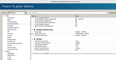

This is not exactly "function depth".
But yes, the critical parameter here is stack size, which is part of the specific project settings.
I don't use CubeIDE, so here an example from another toolchain / IDE:
In most cases, stack size is a parameter retrieved or shown during project creation, a.k.a. "project wizard".
Usually a default setting is presented you can edit at that time, or later on.

‎2024-12-20 2:20 AM
> 1. how many C functions can be call in nested form?
As much as the stack size allows.
In general, toolchains/IDEs are really bad at guessing runtime stack sizes. Set to a ball park figure according to code complexity, and increase if you encounter runtime overflows.
Standard library functions (like "printf()") have a significant impact, be aware.
Many RTOSes provide a runtime stack check option for their tasks, as a side note.
