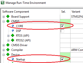

what I did was:
1. I created new Keil project for STM32F407 Discovery.
2. Added Device startup file (And CMSIS dependency)

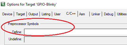

Now in Keil Project, when I include File STM32F4xx.h from standard peripheral library (
https://github.com/pichenettes/stmlib/blob/master/third_party/STM/CMSIS/CM3_f4xx/stm32f4xx.h
) and compile the code without defining target in Keil pre-processor (
STM32F40_41xxx),
I get the missing target error at line 112 (
https://github.com/pichenettes/stmlib/blob/829f9db1b92d8f5a360fba203a412ad05e5aab14/third_party/STM/CMSIS/CM3_f4xx/stm32f4xx.h&sharpL112

So How is it possible that for one file (StdperiphLib) the preprocessor
STM32F407xx
is defined and for other its not??
Kindly help.

Because the StdPeriph requires that you define it in the Project defines, but HAL doesn't.
IF you want to see what's actually happening, look at the Preprocessor output.

Rather than excessively complicate this, just place the correct defines in the command line and make sure the Include Paths point to the appropriate directories, and in an appropriate order, so that a current and coherent set of files are pulled in.
For STM32F4-DISCO board we typically use these defines:
USE_HAL_DRIVER,STM32F407xx,USE_STM32F4_DISCO
The CubeMX F4 trees include HAL examples, and template projects, please use and review these so you have some context about how these should be formulated.
