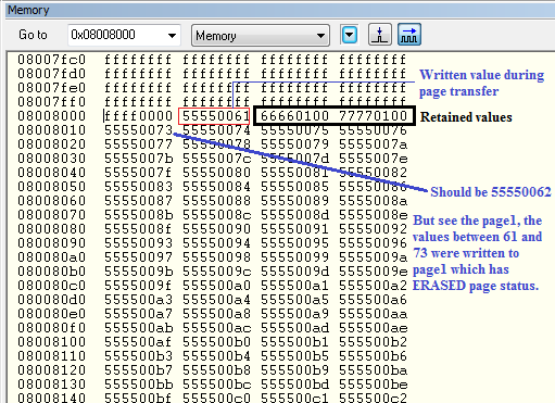

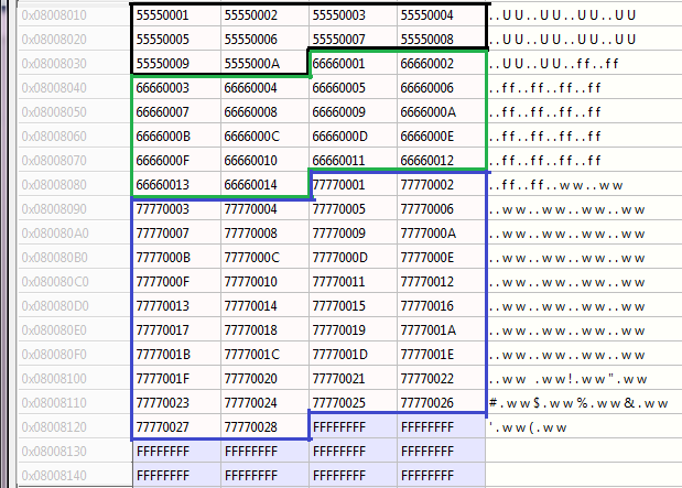

With this code, I was trying to test reliability & correctness when there is overflow from page0 to page1 and page1 to page0. page size is 16kb or 0x4000. page0 start address is
0x08008000& page1 start address is
0x0800C000.
Case 1:page0 to page1
Case 2:page1 to page0
I use ST-Link Utility tool to see the FLASH memory contents. I found Case 1 is working fine.
But not Case 2.
Here is properly written elements for verification.

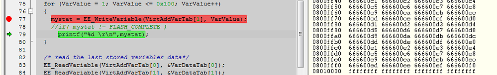

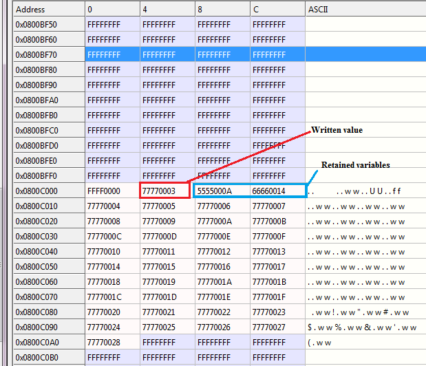

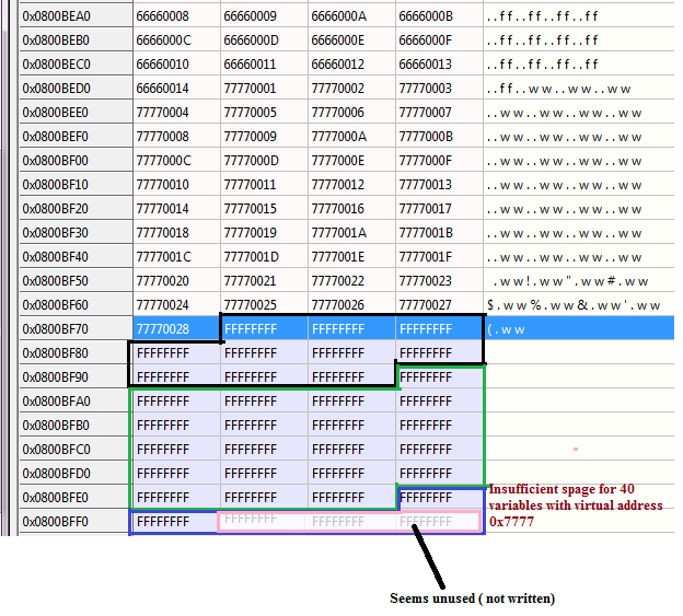

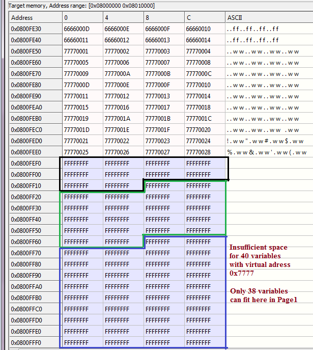

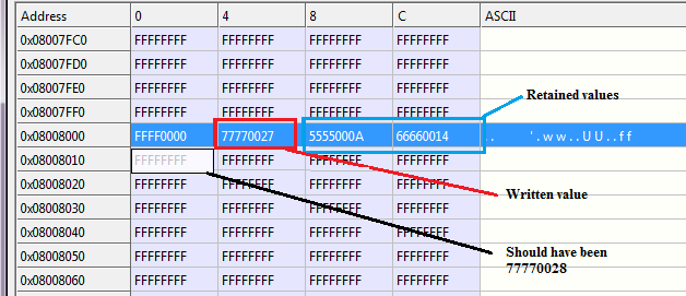

‎2014-07-30 11:01 PM
I have observed several times, the for loop is getting terminated in Case 2.
For example, lets say, now we are in third for loop, found that page1 is full when trying to write 38th variable, The page transfer should happen.During this page transfer, first page0 header is written with REVEIVE_DATA, then 38th variable is written to page0. And finally copies the updated values of variables from page1. Then erase the page1, set the page status VALID_PAGE.At this point we will return back to for loop, and we should still be in the for loop to write the rest of variables ( 39th and 40th), but its getting terminated due to some reason, Don't know why ?- Mark as New
‎2014-07-31 12:13 AM
Replying for myself.
I did step by step debug in IAR, watched flash memory for Case 2. There was no problem, everything works ok.- Mark as New

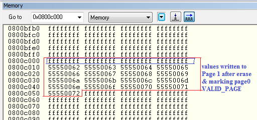

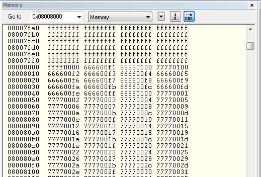

I cleared the SER, MER and MER, PG bits in FLASH_ProgramHalfWord and FLASH_EraseSector function respectively as proposed
. But I started getting a new problem. The remaining data values of for loop are being written in the old page, i.e. page1 after erase.- Mark as New
‎2014-07-31 7:48 PM
Did little more debugging, actually the loop is not getting terminated. But the values are being written to the erased page ( page1) though the page0 marked as VALID_PAGE and page1 ERASED.
Here is FLASH memory contents of Case 2;See page0- Mark as New
