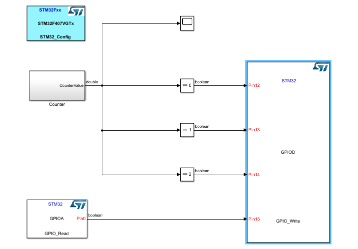

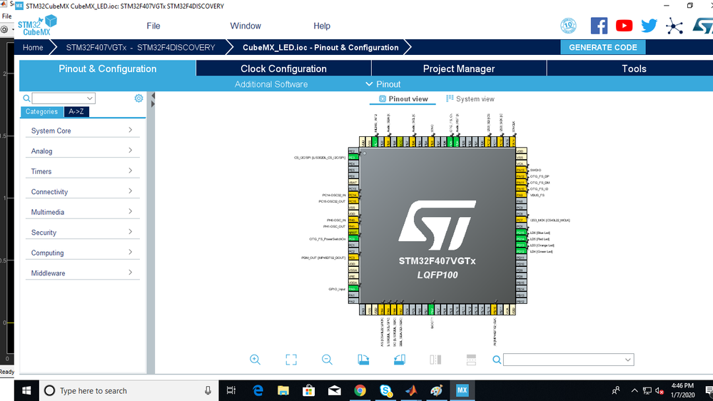

Desired Operation - Blinking of 3 user LEDs on board and 4th LED to glow when user button is pressed.

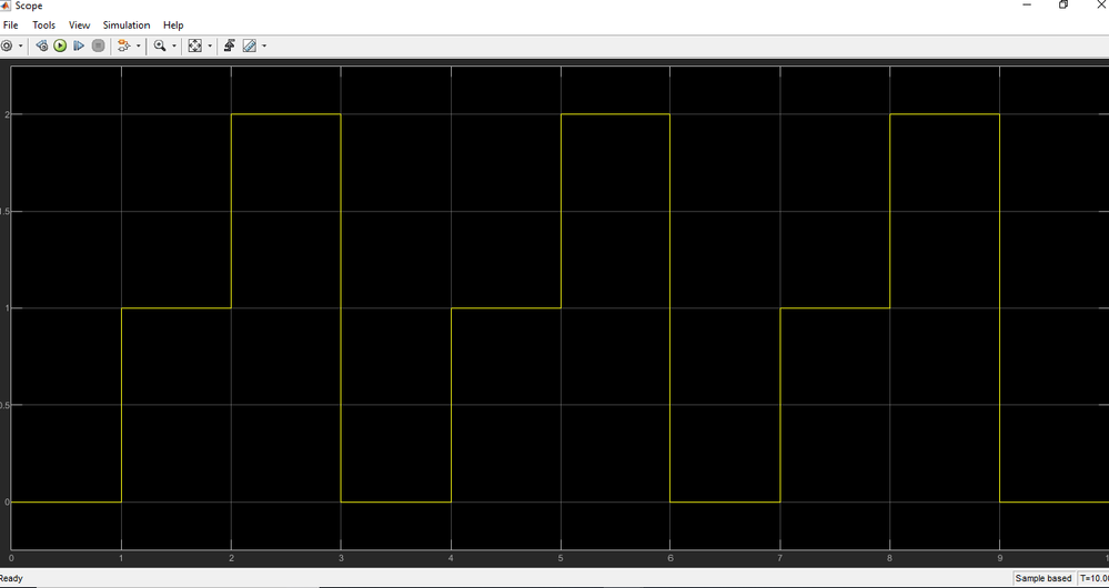

Scope result -
Simulation results confirms that the model is perfectly fine.
GPIO Pin Configuration - PA0 is set to GPIO_input and all other pins are in its default option.
Saving the .ioc file and importing it in the MCU_config blockset .

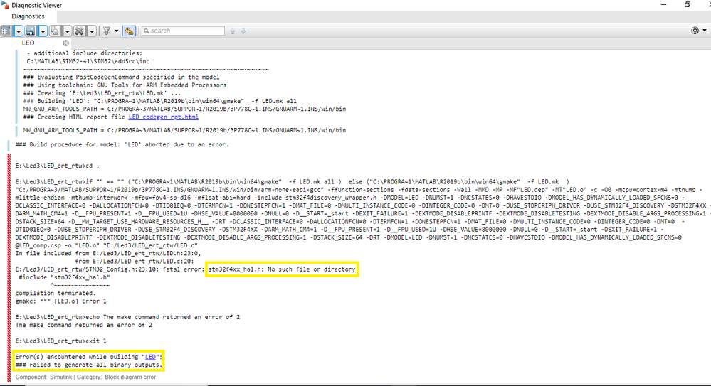

Upon clicking the Build, Deploy and Star. Matlab throws an error.
Aren't the .hal files generated by cube MX and found in my workspace?
I have attached all the required folders.
Kindly help me with rectify this issue.

The build log you provided shows that you are using ert.tlc.
Please see STM32_MAT-TARGET_HandsOn.pdf which is part of the installation files for STM32-MAT/TARGET tool.
For the ST solution, it is mandatory to use stm32.tlc as the System Target File.
Just try to take a look to the Blinking examples that are furnished under /STM32demos/Test/ subfolders.
All examples should work on STM32 targets using STM32-MAT/TARGET V5.4.0 with STM32CubeMX 5.4.0 and R2018B of M%ATLAB/Simulink.

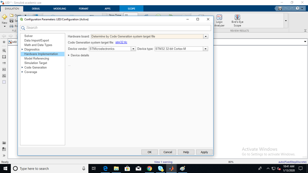

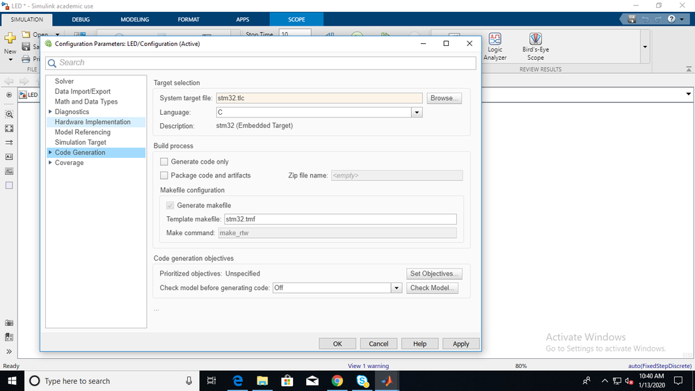

I had intentionally used ert.tlc because only when I select a hardware in the settings, I am able to get the option of Build, deploy and start.
But could you tell me how to deploy the code when I have stm32.tlc as my option setting, because when I select stm32.tlc I am able to get only run option - which is for the PC Matlab Simulation.
Choosing both hardware and stm32.tlc is not possible. I have to choose stm32.tlc and the hardware for code generation is chosen by default, through which I am able to only simulate and not deploy.

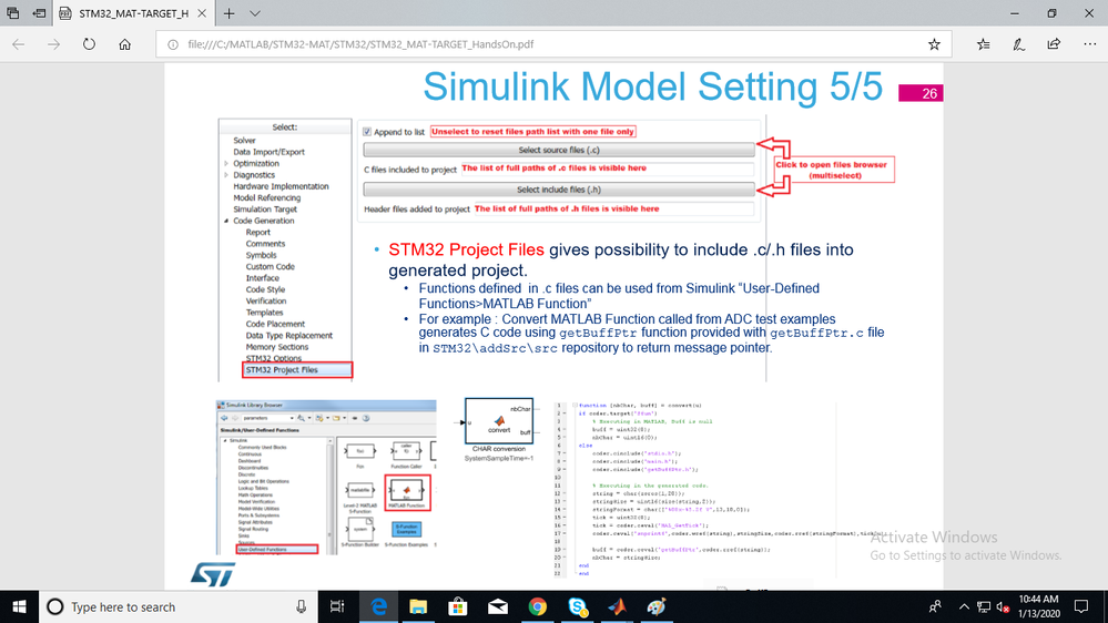

But, in the STM32_MAT-TARGET_HandsOn.pdf, on this page
Will uploading the stm32f4xx_hal.h here, help me clear the above error?

First, you use R2019a of MATLAB/Simulink; this does not correspond to the delivery of STM32-MAT/TARGET 5.4.0.
With the R2019b of MATLAB/Simulink, you can also create and run a stand-alone application, that is result of ST building process.
Just follow the STM32_MAT-TARGET_HandsOn.pdf for a standalone application and ready-to-use test examples in the installation file of the STM32-MAT/TARGET tool.
Note that it is the STM32_Config block for Simulink that selects the hardware defined in the ioc file which corresponds to the STM32CubeMX project.
With toolstrip concept introduced with R2019x of MATLAB/Simulink, just select the Embedded Coder perspective. Build from this Simulink perspective.
Once the project has been generated by the STM32CubeMx tool, just open this project with the corresponding IDE, build and run on STM32 device.
I understand you know how Mathworks solution deploys a standalone application on the target but ST solution is different, relying on STM32CubeMX and IDE tools (Activate Verbose build in Code Generation to follow more details about what is being done).
