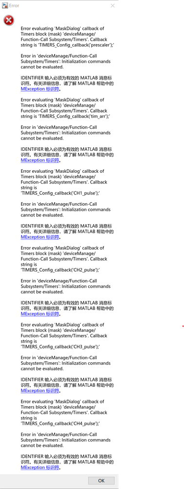

Hi, set stm32H750 tim, Error in 'deviceManage/Function-Call Subsystem/Timers': Initialization commands cannot be evaluated. TIMERS_Config function : Can not find which APB timer TIM1 is connected to.Default preference value STM32TIMAPB set to APB1 is use
lling.1
0690X00000D8vuiQAB.pngHi, set  stm32H750 tim, Error in 'deviceManage/Function-Call Subsystem/Timers': Initialization commands cannot be evaluated. TIMERS_Config function : Can not find which APB timer TIM1 is connected to.Default preference value STM32TIMAPB set to APB1 is used.

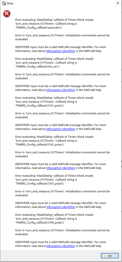

Hi @Cyril FENARD​
I have the same issues with the new release installed. I'm not able to configure and use Timers in my Simulink environment.
Like you can see I'm getting an infinite loop of this error and I need to abort Matlab.
I hope you can help me with this issue.

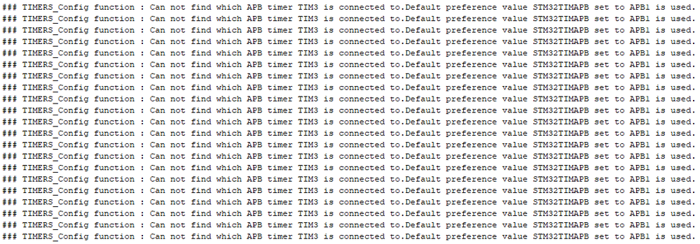

DHofe.1
Hi @Cyril FENARD​
Thank you for your fast answer! Yeah I tried to load the example and it worked without a problem. What is really strange I think.
I executed the required commands and you can find the results in the attached log file.
Update: I tried to configure a second timer in the provided example and I got the same error like before. So I think there is just TIM1 which works properly.
Regards.
Dominik

DHofe.1
Ok, but in the release notes of the newest STM32 MAT/Target is written that the H7-Family is supported. Can you estimate when this will be fixed or at least can you tell me if you're working on this problem at the moment?
Tim is out of trouble now, but the number of adc channels has a problem。
Hi @Community memberngyuan​
Have you tried to use another timer than timer 1? Because this is the only one which works for me. The ADC I never tried before.
