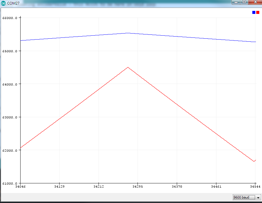

if (lastValue != encoderValue) { //only update if encoderValue has changed
Serial.print(encoderValue); //NOT println to create two seperate traces in Serial Plotter
analogWrite(LED1, encoderValue); //set PWM amount for LED1 linearly
Serial.print(","); //divider to create two seperate traces in Serial Plotter
analogWrite(LED2, ceil(pow(1.000169, encoderValue) - 1)); // --set PWM amount for LED2 pin exponentially
Serial.println(ceil(pow(1.000169, encoderValue) - 1));
lastValue = encoderValue;

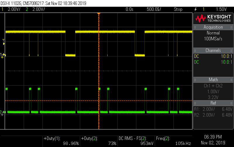

This seems to give me 16bit PWM output from PA8 and PA9 (LED1 and LED2) but looking at it on my scope it gives me all kinds of weird down-going spikes while the encoder is turning that I don't see at all when using the MAPLE core.
It's fine as long as the encoder is not turning though.
The encoder code isn't spitting out random zeros either because if I plot the value being sent to PA8 and PA9 in Serial Plotter it creates perfectly smooth lines.
I guess I'll try it without the encoder and simply use a for loop to increment and decrement a variable I can analogWrite to those two pins instead, to narrow down the problem.
