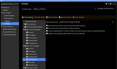

So I ported the code from Arduino IDE to STM32Cube IDE, and compared the results for a blue pill STM32 board (STM32F103C8T6 ). I got very different results. Code compiled in Arduino IDE goes through many more loops than the Cube IDE. If I start with a prime number 1990661, with Arduino IDE code can check 589632 times if its a prime or not. For the same code on the same board flashed through STM32Cube IDE only can check 169176 times. This is about 3.5 times slower. I get similar speed difference when I start with a different prime number.
I have attached both Arduino and Cube IDE code and few picture for reference. Is there anything I am doing wrong that is causing STM32Cube IDE to run slower? I am new to Cube IDE and do not know much. Any help will be appreciated.
Yes. You didnt use a optimizer setting (i suppose).
In Arduino somewhere in the linked libs and defines and everything, there is optimizer set to -O2 or 3.
So try again in IDE, with optimizer set to -O2 (my usual setting), or -Ofast , for best speed.
here:

Great. I changed the setting to -Ofast and the loop count jumped to 609835 which is higher than Arduino IDE. Thanks for your suggestion.

But you dont compare "IDEs" here - you compare the optimizer settings, using same compiler (both use GCC).
