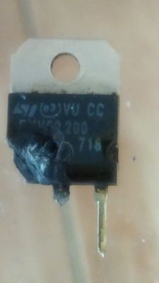

What kind of diode I am seeing here
K76
Good morning to everyone!!
I own a Hps 125A single phase welding machine and the diode has blown and I can't read the part number.The input voltage in my country is 240v  and 50hz.
I am attaching a photo of the component maybe can help
Thank you

xisco
Senior
Unfortunately, the BYV52 dual rectifier and the package have long since been discontinued without replacement. However, you could try the STTH6002CPI as a replacement, although it has a slightly lower surge non repetitive forward current.
Good luck!
