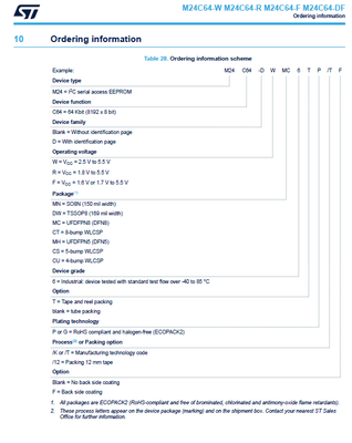

could you advise what the part marking is for below, please?
  1. M24C64-DFMC6TG
  2. ASM330LHHXTR
  3. STTS22HTR
  4. LIS2MDLTR
Kind regards
Mayura
Look at the last pages of the datasheets.
Example for M24C64-DFMC6TG / Ordering information. The marking is detailed here:
If that does not answer your question please open an OLS ticket over this link: https://ols.st.com/or contact your local sales.

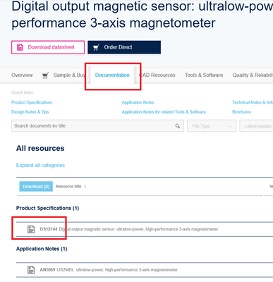

1- M24C64-DFMC6TG: 64-Kbit Serial I2C bus EEPROM: https://www.st.com/en/memories/m24c64-df.html
2- ASM330LHHXTR: High-accuracy 6-axis automotive inertial sensor: https://www.st.com/en/mems-and-sensors/asm330lhhx.html
3- STTS22HTR: Ultralow-power temperature sensor: https://www.st.com/en/mems-and-sensors/stts22h.html
4- LIS2MDLTR: Ultralow-power magnetic sensor: https://www.st.com/en/mems-and-sensors/lis2mdl.html
Go to Documentation tab for the related datasheets:
Hope it helps.
