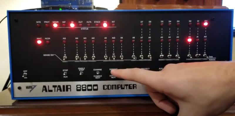

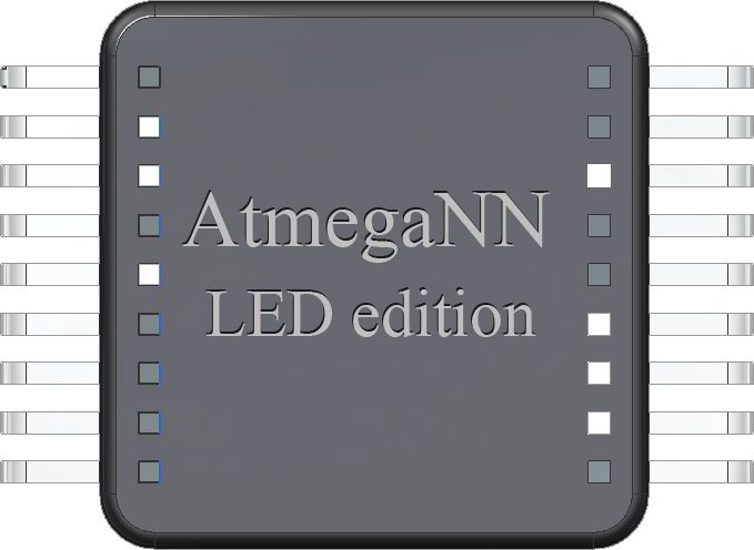

I had an idea for debug microcontrollers, so that there were microcontrollers with a light display of the receive-transmit channel. Such chips will be in the category of debug chips, when a circuit is being developed and it is much easier for the code to. When there are many microcontrollers in operation on a single-wire protocol and each with its own external functions, then heaps of wires and external LED displays become inconvenient. And everything is so compact and clear.

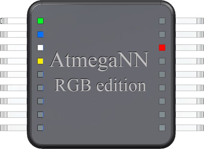

And this is an example of the rgb version of displaying data exchange processes.

If I understand your idea correctly, you would like to suggest an MCU that has a built-in RGB LED on each pin?
Very good, but who should pay for it:
- 3 LED chips per pin
- current limiting resistors
- light windows per LED?
- How is that supposed to fit into very small packages?
Where should the power loss of the series resistors be dissipated?
Will also be difficult to squeeze 225 RGB LEDs into a BGA, for example.
How should you operate LEDs when you work with 1.62V and LEDs rarely have a forward voltage drop of less than 2V today?
Hmm, sounds like a good idea, but it probably isn't really feasible.
Regards
/Peter

This is for TTL chips. The rgb version might be too tricky. I gave the second option as an example. If there is a smd solution, then micro smd execution may appear. The buyer will pay. Debug chips, project formation always contains many searches for why it does not work. Visibility helps a lot to understand the possible cause. In addition, if the versions are ~ 0.25mm ... 0.5mm in size and fit into the chip casing during manufacture. It will cost more, but it is more convenient to work with. Time is money.
