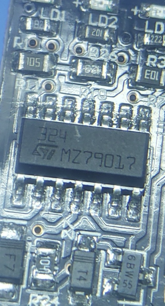

I have a product using a 14-pin STM324 MZ79017—I am unable to find any technical literature on this IC. What type of component is this?

Peter BENSCH
Would you be so kind as to include a photo of this device in question?

Uwe Bonnes
Principal III
LM324 variant?
Certainly, yes, this is how it looks against the light:
0693W000005CtdRQAS.pngThanks!
I'm not sure since I'm unable to match the GND of LM324 against the corresponding pin on this component, which isn't very promising.
Peter BENSCH
As Uwe Bonnes suspected - it's the LM324.
