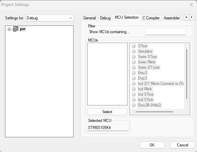

Hi ST support team,

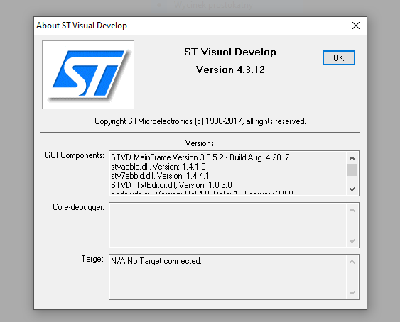

     I'm using STVD version 4.3.12,  no matter create an empty project or open the existing project.
 The MCU selection in Project Setting always empty.  But the same STVD installation package works in some other computers.
     My computer is 64-bit x64-based processor, running Windows 11 Enterprise Version 24H2.
     I tried re-register dao360.dll in administrator CMD, there was a period when it could be resolved, but I'm not sure if it was due to Windows updates or some other reason. Now it's not working anymore.

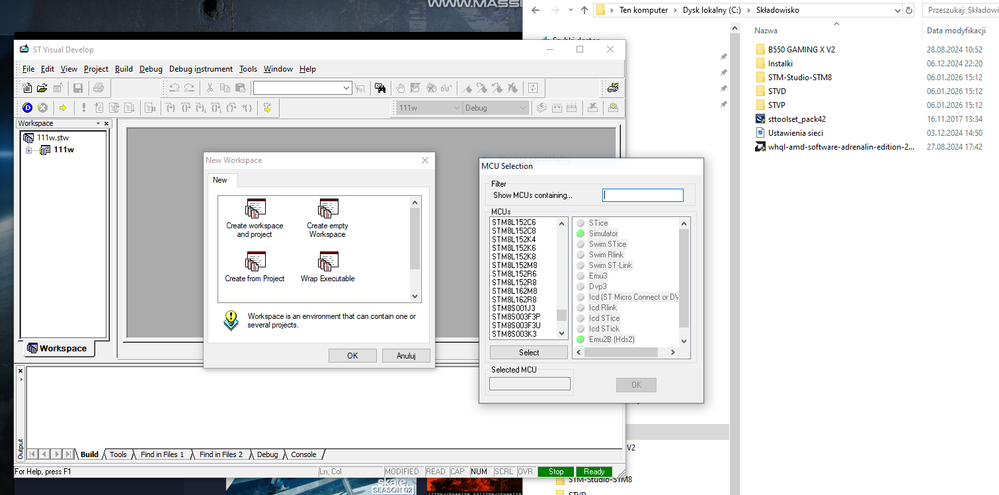

Hi. I tried to install STVD with:
https://www.st.com/en/development-tools/stvp-stm8.html
On windows-10 64-bit. So quickly, I just checked if I could choose a microcontroller for a new project. And it's OK. Screenshot:
On virtualbox on linux (W7-32bit) I have this:
Maybe uninstall everything and install from that location?
During installation, I confirmed the installation of the default drivers.
