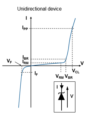

According to datasheet of SMBJxxA series, may i know do we have any option having voltage is 60V? Part number SMBJ60A is not valid in Datasheet.
1 REPLY 1
Options are listed in the datasheet. Probably SMBJ58A is suitable. The voltage refers to the end of the linear-ish region (V_RM). Diode doesn't turn on until a bit after that.
