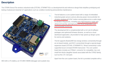

Andrew Neil
@huggo67 wrote:
I want to install different sensors (measuring vibrations, energy consumption, and temperatures) on construction platforms so I can collect real-time metrics from these sensors and upload this data to a database for later analysis.
If you want a ready-made unit to do this part, consider:
STEVAL-PROTEUS1Industrial sensor evaluation kit for condition monitoring based on the 2.4 GHz STM32WB5MMG module
STEVAL-STWINBX1 - STWIN.box - SensorTile Wireless Industrial Node Development Kit
STEVAL-STWINKT1B
Meanwhile, it's an NRND product (not recommended for new design).
