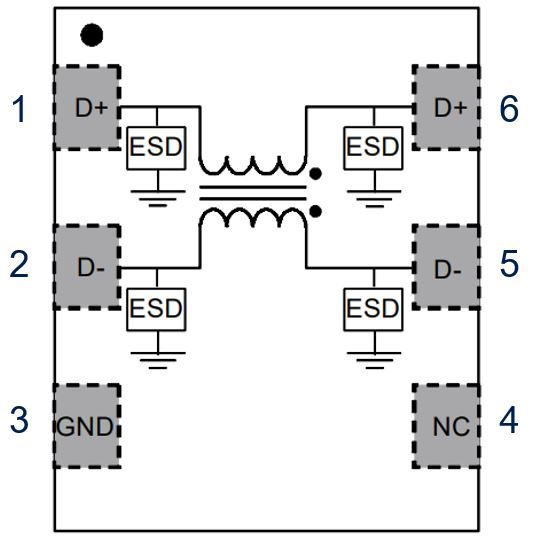

Please provide the pin numbering details for the part ECMF02-2AMX6

Is below picture what you are looking for?

Thanks, this is the one i am looking for.
Can it is possible to connect D- signals to PIN no 1 & 6 and D+ signals pin 2 and 5 ?

Yes, you can connect D- signals to PIN no 1 & 6 and D+ signals pin 2 and 5.
