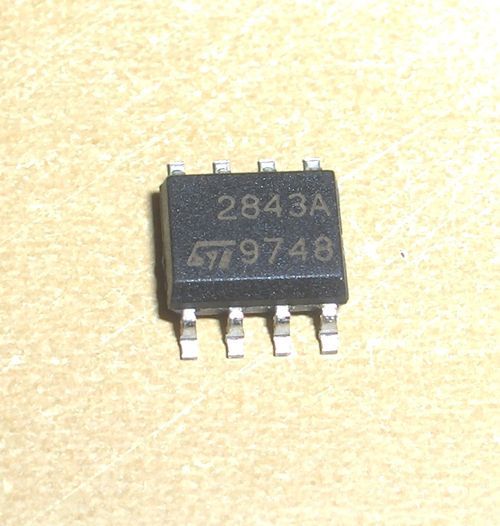

I recovered an old component with the marking 2843A ST.
Can't find the Part number? UC2843AD1? An idea?
Thanks
What did you "recover" it from? That may well provide useful context to narrow-down you search ...
PWM controller?
https://www.jotrin.com/product/parts/2843B#:~:text=2843A%20with%20circuit%20diagram%20manufactured%20by%20ST.%20The%202843A%20is%20available%20in%20SOP8%20Package
Peter BENSCH
Yes, it is the US2843AD1, obsoleted long ago.
You can check whether you can replace it with the UC2843BD1, which is pin-compatible but differs slightly in some respects.
