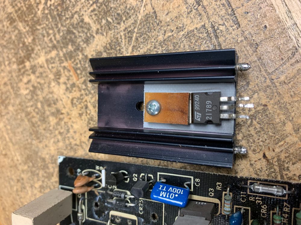

Need help identifying ST 99240 21789 Has 3 leads, was in a Power-One SPL53-4000 ASSy 75114 101-Y quad output power supply +5 -5 +12 -12 volt outputs.

Is the device numbered U1, U2, U3 or Q3, Q4. Q7?
Would it be possible to upload a photo of the device where the marking is as legible as possible?

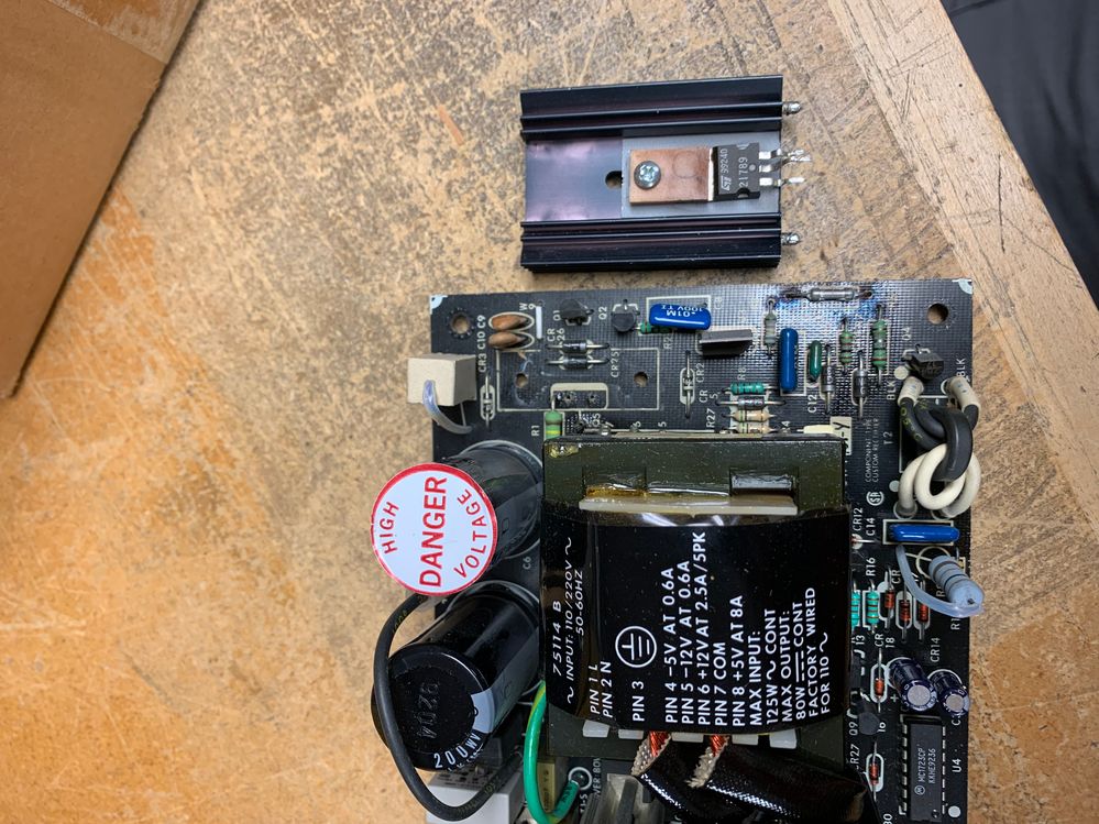

0693W00000Y7JKjQAN.jpg0693W00000Y7JKoQAN.jpgHi Peter,Thanks for the reply.
The component in question was Q5 of the power supply.
Here are a couple pictures of the component and where it was located on the board.
Would you happen to have a schematic for the power supply?

Hi Greg,
thanks for the photos, but please delete the double-posted images below as this only confuses other users.
Unfortunately, there is no more information about the 21789, which was discontinued in 1997. I could only find out that it is a bipolar transistor (BJT) in package TO220, almost certainly also an npn with 500...700V collector voltage. Probably the BULD38D or a comparable type could be used instead, which can be found out by re-engineering the circuit. Only the manufacturer Power-One, now called Bel Power Solutions, has a circuit, but rarely does anyone give out their documentation. However, a photo of the bottom side of the power supply can also be found on Ebay, from which it is quite easy to reconstruct the circuit for such single-layer boards.
