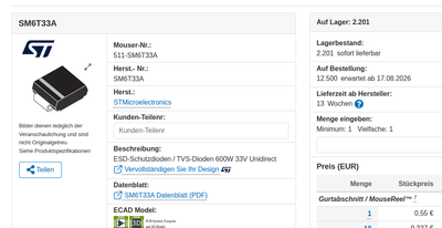

identify this diode ?
L67
Visitor
Can anyone identify this diode and suggest an alternative please?
ST E
ET
C453
AScha.3

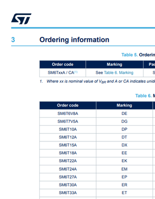

probably:
ET
SM6T33A
SGS-Thomson Microelectronics
DO-214AA
Transient voltage supressor
Vrwm=28.2V, Vbr=31.4..34.7V, 13.1A, 600W(1ms)
from ds:
ET  marking.
at mouser:
why alternative ?
similar 28V :
cheaper, more peak current: 100A
