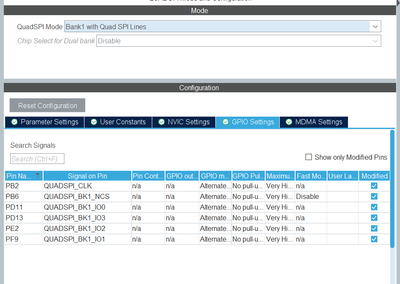

The QSPI flash is not functioning correctly when used with an external loader on my custom board. I utilized the MT25TL01G_STM32H750_DISCO.stldr loader, but the erase operation fails, and the flash does not behave as expected.
in above statement. we have enabled QSPI bank-1 as in below picture
Using the specifications mentioned above, I successfully implemented custom firmware to enable read and write operations on the MT25QL512ABB8ESF-0SIT flash memory. I followed the "W25Q Flash PART 7 -> QuadSPI Mode" tutorial to achieve this functionality. The implementation has been thoroughly verified and is working as expected.

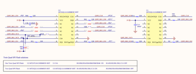

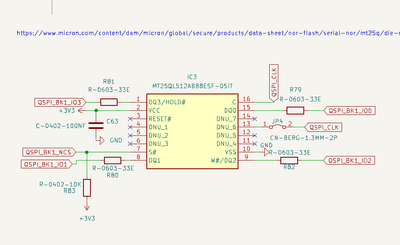

Upon comparing the hardware connections, I noticed some differences. Please review them and let me know if there are any mistakes in either the hardware setup or the software configuration. below i have added screen-short of schematic.
Circuits:
Custom board:
DEVKIT:

Hello @naveen;
Similar issue is reported here.
You’re used (PB2, PB6, PD11, PD13, PE2, and PF9) a different QSPI pins used by STM32H750B-DK (PF10, PF9, PG6, PD11, PF7, and PF6). So, you can’t run MT25L01G_STM32H750B-DISCO external loader in STM32CubeProgrammer.
I recommend you to look at MOOC - External QSPI loader how to - YouTube and get inspired to create your own external loader.
Thank you.
