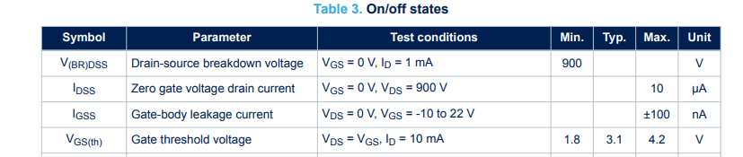

I want to check switching behavior of MOSFET with various Vth voltage (as mentioned Vth range in datasheet). I am doing simulation on this part number: SCT012W90G3AG_V3 in LTspice. Datasheet shows range of VGS(th): 1.8 V(min), 3.1V (typ.) and 4.2V (max) as per following snapshot.

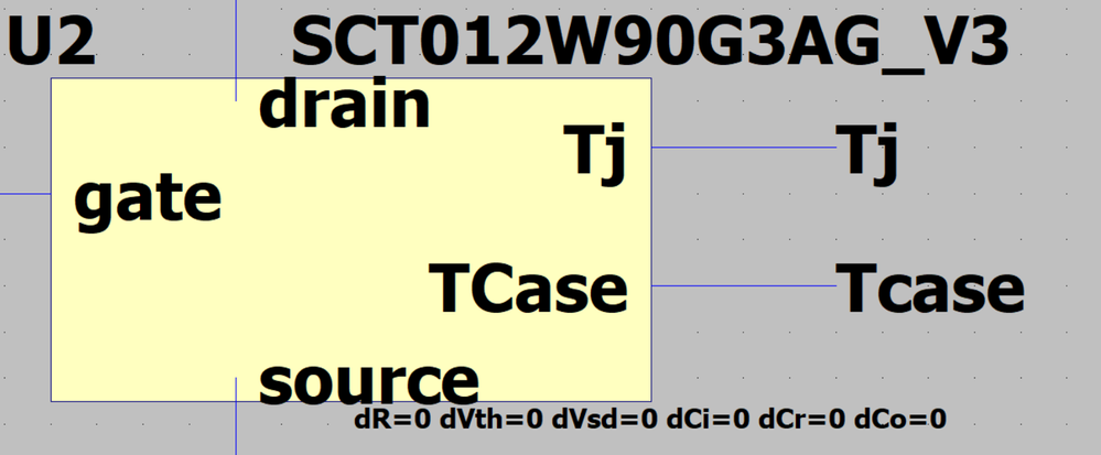

_legacyfs_online_stmicro_images_0693W00000bkZozQAE.pngAnd I also observed one specific note on spice model like dR=0 dVth=0 dVsd=0 dCi=0 dCr=0 dCo=0.
Could you tell me, why this one is given with spice model?
