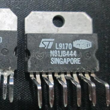

I am currently analysing a project that uses a ST L9170 voltage regulator.
I have 3 units and I wanted to test them in order to make sure they are working properly but it seems that there is no datasheet or any info available regarding this component.
I know for a fact that this is a voltage regulator and that it is used in several vehicle ECUs.

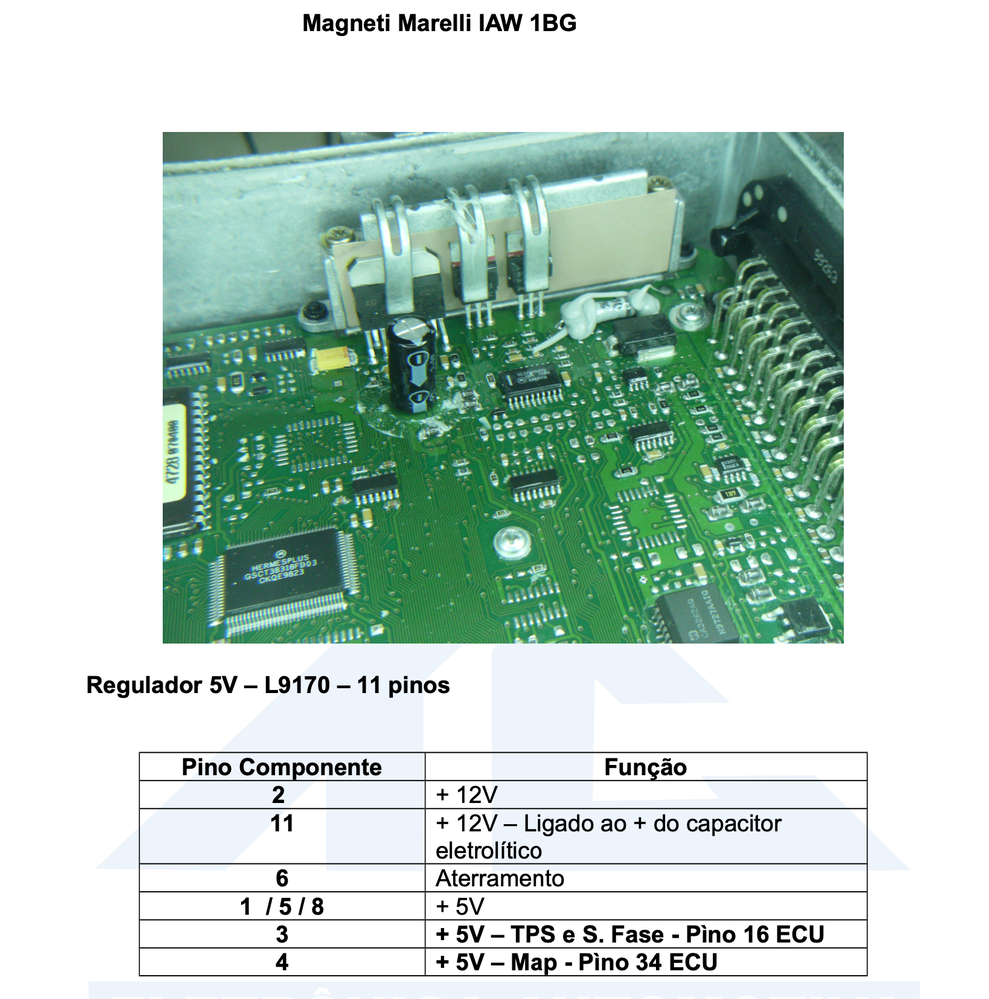

I have also found a document that shows reference voltages at the Pins of the L9170 of an ECU. But I don't know if this information is correct.
Pin 1 - +5V
Pin 2 - +12V
Pin 3 - +5V
Pin 4 - +5V
Pin 5 - +5V
Pin 6 - GND
Pin 7 - No information
Pin 8 - +5V
Pin 9 - No information
Pin 10 - No information
Pin 11 - + 12V
Can you please let me know if you have any clue on how to diagnose this components? Anything will be helpful and I really need to sort this out.
