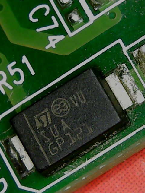

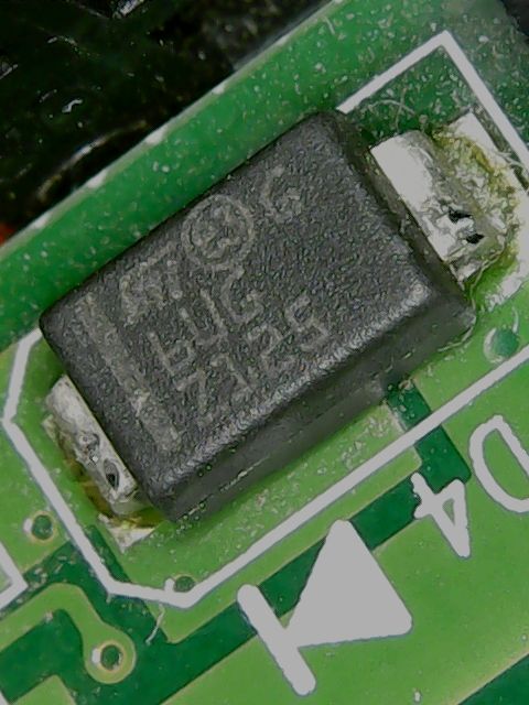

I need help identifying the code of these two diodes in the photo.

BUG is here Datasheet - SMBJ - 600 W TVS in SMB - STMicroelectronics https://www.st.com/resource/en/datasheet/smbj58ca.pdf
BUG SMBJ15A
SAU SMA6F5.0A-TR (6AI)
