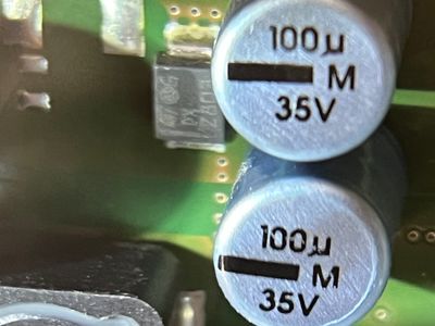

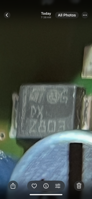

Another diode to identify
Maxfi2000
I had someone to identify the wrong diode.
The diode I need identified is
st e3 g
dx
z803
thank you, in advance, for all of your help in identifying the diode!
Peter BENSCH
The marking DX stands for the SM6T15A.
Good luck!
Regards
/Peter
