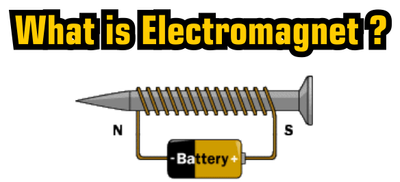

From the page you linked:
https://robu.in/what-is-electromagnet/
i have read all the comments and okay incase, if we consider magnet has 2 terminals which are positive and gnd. okay i connected that to the power supply of 24V. then where can i configure the magnet has to pick or place to? i have used the same magnet with my clearcore board, i have connected that to positive and signal. so i am sure, it is signal which i had configured in my code. and to be again clear, my electromanget has only two termnials wires connected to it.
And in the schematic i have to have 3 wires coming from the magnet. but i have only two. once check the link which i shared earlier to see what magnet i am using.

If it is connected to the power it is on. If it is not connected it is off. In order to change if it is off or not you use a switch. A switch makes or breaks the connection of the magnet to the power. So a switch can turn the magnet on and off.
@suhfi this is shown on the page you linked - here, a battery supplies the power:
