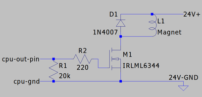

i am using electromagnetic sensor which is 24volts. in that i only have the connections for power voltage(positive) and the signal. when i am trying to power it with my stm32f411re nucleo board i can see that the power isn't sufficient. so can i use a 24volts power supply to that and the negative to the stm32f411re nucleo board ground.
so i was thinking the connections would be like,
power supply positive to the sensor positive, signal to the stm32 nucleo board. power supply negative to the ground of the stm32 board.  would these connections make sense, or would it fry my board?
is there any quick connections to power the sensor with 24volts. quickest answer is much appreciated. thank you in advance.

@suhfi this is shown on the page you linked - here, a battery supplies the power:
@unsigned_char_array wrote:
In the schematic that was provided, a MOSFET (a type of transistor) is wired as an electronic switch. This is a switch that can be turned on and off with an electronic signal. That signal comes from the MCU..
@suhfi  This is that schematic:
'M1' is the MOSFET - it performs the function of the switch;
'L1' is the electromagnet;
The '24V+' and '24V-GND' are the power supply - equivalent to the battery;
The 'cpu-out-pin' is the signal from your STM32 microcontroller which controls the "switch" - to turn it off or on.

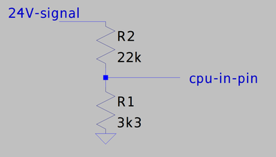

Most simple input:
In industrial use standard is to use an opto-coupler ; to separate also the ground of the low level circuit/cpu from outside. If you have the same ground, just shown 2 resistors are fine.

So you need a transistor or mosfet to switch it : here with logic level mos :
so, i am so sorry but i didn't get you. The cpu-out-pin and cpu-gnd. are these the pins in stm32f411re board.?

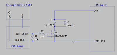

The project i am doing needs to be connected to the magnet which has the input of 24V. And stm32f411re gives up to only 5V. in my magnet connections, i only have positive( which is 24V) and the signal pin. the signal pin is connected to the nucleo board as to define the digital value to the electromagnet. But the biggest concern to me is 24V positive power to the magnet. How to connect it?
Can it be connected with the power supply of 24V and then where should i connect my negative of the power supply to. should it be connect to gnd.? can i common the gnd of all the wires coming output of 5V and 24V.
NO ! its a 3V3 system !!!!
signal pin : on F411 : any free pin , you set in Cube as your "magnet-out" , set: lo .
okay, i understand that stm32f411re gives upto 3V3. And, where is cpu-out-pin and cpu-gnd is located on my nucleo board stm32f411re. i connect stm32 nucleo board through usb port.

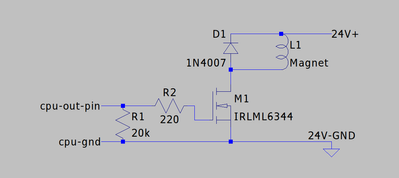

i have another doubt as i have a magnet which is DC 24V P40/20. the output wires for these are positive and signal. Here is the link to the magnet
https://robu.in/product/dc-24v-p40-20-30kg-lifting-solenoid-electromagnet/
you can see here only 2 wires are there, and in the schematic which you shown has the connections of magnet to the diode which is not possible in my case. could you please be more detailed. thank you.
WHAT ?  2 wires from magnet -> to diode are not possible for you ???
