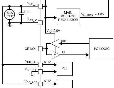

I'm using STR750 Eval board and the example : STR75xStdLib/example/GPIO.
Of course I changed this (instead of 3V3) :
/* GPIO pins optimized for 5V operation */
MRCC_IOVoltageRangeConfig(MRCC_IOVoltageRange_5V);
Then :
/* P2.19 and P2.18 in Push Pull mode */
GPIO_InitStructure.GPIO_Mode = GPIO_Mode_Out_PP;
GPIO_InitStructure.GPIO_Pin = GPIO_Pin_18 | GPIO_Pin_19;
GPIO_Init(GPIO2, &GPIO_InitStructure);
GPIO_Write(GPIO2, 0x00);
I get a 3.3V output on 2.19 (CN7).
What's wrong ? Is there a mask to change ?
I'm using a power supply jack (5V).
JP1 : PSU and DTB fitted.
JP3 : CPU_3V3 fitted.
JP4, JP5, JP6 : not fitted.
Thank you in advance.

I think that you have made a misunderstanding about 5Volts subject.
STR75x from ST is 5 Volts tolerant this does not mean that It will output
5volts but it Handles 5 Volts inputs and the output is always 3.3Volts.
If you are interesting to have 5 Volts output, you can use the STR73x series from ST which I found the only ones within the ARM7 micros in market able to drive directly 5volts outputs.
I hope this may help you and make things more clear :-]

STR750 can operation as either a 5 volt or 3.3 volt device, the I/O output will be at the supply voltage level minus a diode drop.
The only difference on the schematic between 3.3 (Scheme 1) and 5.0 (Scheme 3) is providing 5 instead of 3.3 volts.

Well, i'm still confused... especially when I look at this scheme 3 :

Well, I haven't seen that the STR75x can operate in Dual Supply with (scheme3).
Here attached the confirmation that you can have a minimum I/O output at (VDDIO- 0.8) from STR75x Datasheet : So , Yes it is possible.
However, if you have the STR750-EVAL from STMicroelectronics, It seems that the scheme3 is not implemented and you have to rework the board or to design your own board with Scheme3 model to have 5 Volts Outputs.
