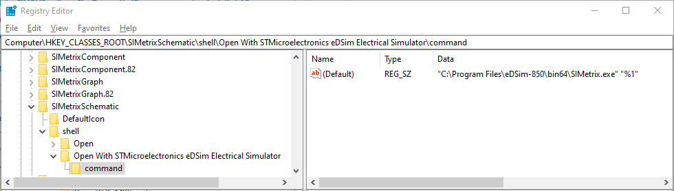

Marco FICHERA
Hi @EHD​ ,
you should see something like this in your registry:
With the reg key reporting something like this:
"C:\Program Files\eDSim-850\bin64\SIMetrix.exe" "%1"
